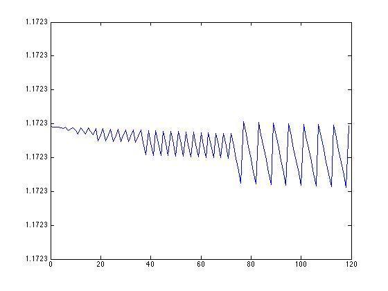

I have to plot a bunch of cosine waves and then add them up but my problem is that each indiviudal wave looks really weird when I plot and not like a cos wave. The program runs and plots the final result but I'm not sure how accurate it is because when I plot each individual cos wave I know it should not look like that
This is my method,
t=[0:119];
a1=9.8;
f1=200;
P1=0;
s1=a1*cos(2*pi*f1*t+P1);

These are what s1 and s2 look like. They should both just look like regular cos waves but I am not sure why theyre looking like that. They should just be cosine waves with certain frequencies aplitudes and phase shifts given by a, f, and P.
Your range for t is the interval [0, 119]. The cos function in Matlab probably expects its argument to be in radians, not degrees that I believe you think you are using. To convert radians to degrees, multiply the degree value by 180/##\pi##.
You probably need to define a smaller step in the t vector.
Matlab does not know about the whole curve - what you are doing is sampling the curve at particular points.
I your first curve, you are sampling at intervals that are a whole number of periods - so you get the same value for the sine wave for every value of t. In the second one, the sampling interval means that the data points alternate between low and high values - giving a saw-tooth effect.
For MATLAB to show you the curve of form ##\sin(2\pi t/T)## you have to set up a time vector t=a:dt:b; so that ##dt<T/10## ... the more data points you get in one period, the smoother the resulting plot will look.
So for the first one - T = 1/f = 1/200, so t=0:1/2048:119;
Even so the graph is going to be very squashed to fit it into a MATLAB graph window.
Try plotting for shorter lengths of time.
The scale-factor ##2\pi f## in each equation should make sure the argument is already in radians.
JIC: check that your units for frequency are the inverse of your units for time.
i.e. f=200 should give 200 cycles in 1 time unit.
[edit] the P1, P2 etc values should be in radians too.

Ahhh that fixed up the graphs. My problem now is that i have 5 cosine functions with different frequencies and amplitudes. They all range from 0:119ms so i wrote it as
t=[0:0.001:0.119] i chose 0.001 for dt because i can only have 120 time steps. The problem with this is that though it gives a nice cosine curve for some of the functions, it does not for all. Is there a way to get around this?
It could mean you cannot plot the whole 119ms on a single graph.
How come you are restricted to only 120 time steps?
BTW: if you want to have N steps in a range from a to b, then you want: t=a:(b-a)/N:b; ... which will give you N+1 data points. (Notice you don't need the square brackets to set this up?)
