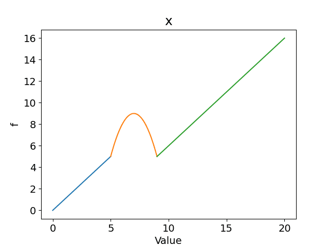

Echoing @pbuk, yes, this is possible.
Here's one that I just did that is similar to what you're trying to do.
I fiddled with the formulas to make a continuous graph.
$$f(x) = \begin{cases} x & 0 < x \le 5 \\ -(x - 7)^2 + 9 & 5 < x \le 9 \\ x - 4 & x > 9 \end{cases}$$
I used NumPy linspace() to create separate arrays of x values for the three different domains, and from them created arrays of the corresponding y values. Then it's straightforward to plot the three sets of x and y pairs.

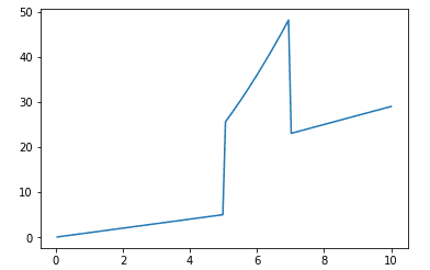

Anyway, as we now have one way of doing it here is how I would do it:
Python:
import matplotlib.pyplot as plt
from numpy import linspace
def fn(x):
    if (x <= 0):
        return None
    if (x <= 5):
        return x
    if (x <= 7):
        return x * x
    # x > 7
    return 2 * x + 9
# Create x coordinates.
xList = linspace(-10, 10, 256)
# Calculate y coordinates using a list comprehension.
yList = [fn(x) for x in xList]
plt.plot(xList, yList)
plt.show()
And this is the result:
I am not sure if matplotlib can better show the discontinuities.

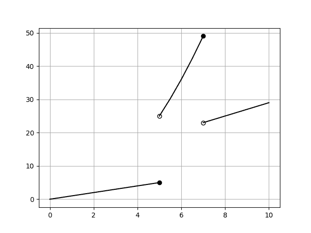

Probably requires plotting a different series for each domain.
Code:
import numpy as np
xs1 = np.linspace(0,5,11)
f1 = lambda x: x
ys1 = f1(xs1)
xs2 = np.linspace(5,7,5)
f2 = lambda x: x**2
ys2 = f2(xs2)
xs3 = np.linspace(7,10,7)
f3 = lambda x: 2*x+9
ys3 = f3(xs3)
fig = plt.figure()
ax = fig.gca()
# Continuous parts
ax.plot(xs1, ys1, 'k-')
ax.plot(xs2,ys2, 'k-')
ax.plot(xs3,ys3, 'k-')
# End points of domains:
# Open circle if x-value is not included in that domain, filled circle if it is.
ax.plot([5.0, 7.0], [f1(5.0),f2(7.0)], 'ko')
ax.plot([5.0, 7.0], [f2(5.0), f3(7.0)],
   marker='o',
   fillstyle='none',
   markeredgecolor='k',
   linestyle='none'
ax.grid()
plt.show()

That's much better than my amateur effort - glad a professional has arrived!
You can get the discontinuous line all in one series by replacing:
Python:
# Continuous parts
with
Python:
# Concatenate the continuous parts, inserting (x, None) for the discontinuities.
xsAll = np.concatenate((xs1, np.array([5.]), xs2, np.array([7.]), xs3))
ysAll = np.concatenate((ys1, np.array([None]), ys2, np.array([None]), ys3))
ax.plot(xsAll, ysAll, 'k-')
