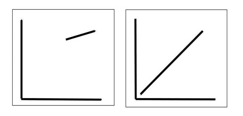

to follow through on both my statement and also to exemplify what Merlin said at the end, consider these two graphs. They are of exactly the same data but the second one has had the axes modified so that the graph "take up most of the graph paper". I consider the first graph to be just fine and the second one sucks because at first glance you have the immediate impression that the slope is 45 degrees. Admittedly, the second one will give more clarity of the exact value of the points and there is some merit in that.
I agree with your tutor. If you are trying to calculate the slope by reading off Δy and Δx from the graph and calculating Δy/Δx then arranging for your data points to fill the graph/page will give you a more accurate answer.
