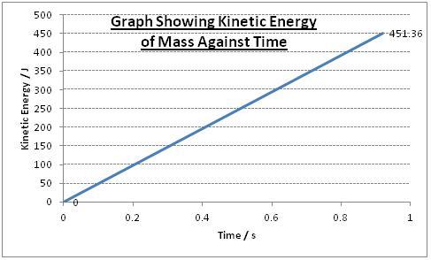

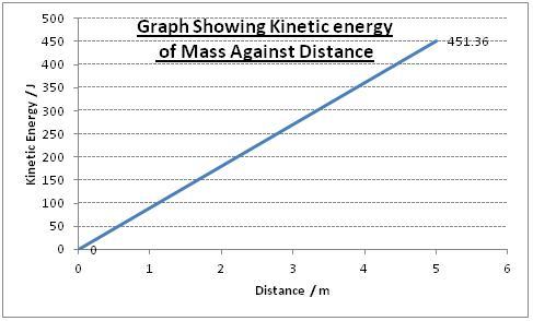

Thanks for your help. So I've got:
Kinetic Energy= (mass × velocity^2)/2
K.E.= (mv^2)/2
Velocity= initial velocity+(acceleration ×time)
V=v0+at
Work=mass ×acceleration ×distance
W=mad
a= w/md
a= 400/(6 × 5)
a=13.33 ̇m/s
V=v0+at
V=0+(13.33 ×0.92)
V=12.266 ̇ms^(-1)
K.E.= (mv^2)/2
K.E.= (6 ×12.266^2)/2
K.E.=451.36J
With my graphs looking like the attachments. Does this now seem correct?

Should KE change at a constant rate?
Lets see, v is proportional to t since v(t)=at
KE is proportional to v-squared
so how does KE change with time?
If you still don't see it, computer the kinetic energy at times: t= 0.1s, 0.2s, 0.3s etc and plot them.
(I could just tell you but if you do this you will learn.)

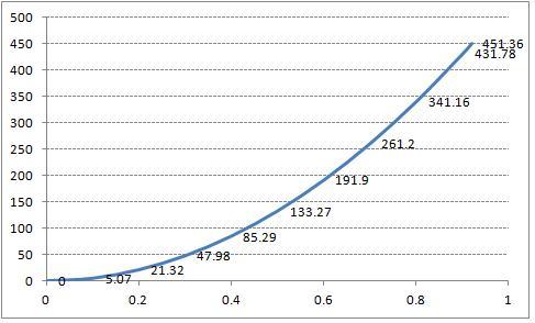

Time v K.E.
0 0
0.1 5.07
0.2 21.32
0.3 47.98
0.4 85.29
0.5 133.27
0.6 191.9
0.7 261.2
0.8 341.16
0.9 431.78
0.92 451.36
So Kinetic Energy will increase exponentially?
Thanks for you help so far it's been awesome of you.
Confirm your conclusion! If it is exponential, then a plot of ln(KE) against time will be a line. Is it?
What if you plot KE against t2: is that a line?

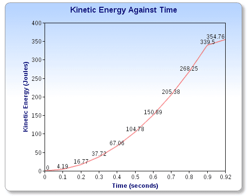

here is the graph i have for kinetic energy against time
i am now working towards the kinetic energy against distance graph, any help is much appreciated!
