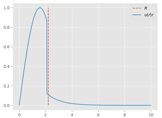

Plot the wave function ##u(r)## as a function of ##r## from 0 to 10 fm. Since ##u##is not normalized, you won't need units on the y axis.
$$\frac{-\hbar^2}{2\mu}\frac{d^2u(r)}{dr^2}+V(r)u(r) = Eu(r)$$ Where $$V(r) = \begin{cases}-V_0 \quad r<R\\ 0\quad r>R\end{cases}$$ Which has the solutions previously found to be
$$u(r)=\begin{cases}A\sin(kr)\quad r<R\\ De^{-\kappa r}\qquad r>R\end{cases}$$
To plot ##u(r)## we need to find the solutions for each region. Which is in the relevant equations part. Now, I have to do this numerically. Using python 3.7 I made an ##u## which is filled with zeros and a for loop with if/elseif statement, basically telling it to plot values for whenever ##r<R## and ##r>R##. Here is the plot generated by my simple code
Due to continuity at $r=R$ they need to have the same value. Which makes me believe that this is a root finding problem, basically ##A\sin(kr)-De^{-\kappa r}=0## Now I don't know how to implement this onto my code, at first I thought make another elif statement for when ##r==R## to use the roots as the values, how would I go on about this problem? Have I forgotten something?
You have some prepping to do that it is better done with pencil and paper, not code. At ##r=R##, the wavefunction and its derivative must be continuous. This will give you a relation between ##k## and ##\kappa## which you will have to solve numerically (the root finding part) to find ##k## and ##\kappa## for an assumed numerical value of ##V_0.## Then you can write the unnormalized wavefunction in terms of ##A## or ##D## and plot.
I found that ##k\cot{kr} = -\kappa## which comes from the fact that we claim ##u(r)## to be continuous everywhere and it's derivate too, then I just divided to get rid of the coefficients, where ##k^2=2\mu(E+V0)/\hbar^2## and ##\kappa^2=2\mu E/\hbar^2## if that's what you're asking ##V0=35MeV## and I found that ##E=-2.223 MeV## This should be everything to plot this right?
Before plotting, I would evaluate ##u(r)## and its derivative at ##r=R## to make sure that I did not make any mistakes. Also, if you are not going to normalize ##u(r)##, be sure to use one of the continuity equations in order to write ##u(r)## in terms of single constant, ##A## or ##D##.
