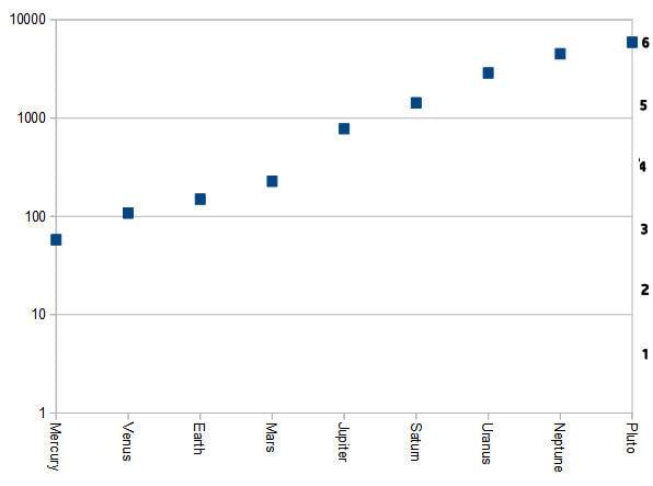

If I take the natural log of the orbital radii (as measured in millions of km), I get
Mercury = 4.05
Venus = 4.60
Earth = 5
Mars = 5.4
Jupiter = 6.66
Saturn = 7.27
Uranus = 7.96
Neptune = 8.4
Pluto = 8.6
If I plug those values into a spreadsheet and plot them on a log scale, I get:
With the y-axis in millions of Km
If we set Pluto at Six ft (72 in) then the log scale should be
Mercury = 37.6 in.
Venus = 38.5 in.
Earth = 41.9 in
Mars = 45.2 in
Juptiter = 55.8 in
Saturn = 60.9 in
Uranus = 66.6 in
Neptune = 70.3 in
Pluto = 72 in
Which roughly lines up with the numbers along the right side of the chart denoting ft above the floor. (I manually added these to the image, so they are not perfectly spaced.)
Heh. That was how I was thinking about solving it: brute-forcing it by plotting it on a chart, then measuring it in pixels. :)
(It'll be even more linear when I add the AB/Ceres.)
Thanks!
A logarithmic scale cannot include the Sun. 0 is infinitely far away. While you could take the radius of the Sun it would still be very far away from the rest.
Let's take Janus' logarithms: They range from 4.05 to 8.6. You want 8.6 to correspond to 72 inch. If you put Mercury at 19 inch then you get a simple linear relation. A range of 4.55 is now 53 inch, that's almost 10 inch per 1 different in the logarithm. Simply multiplying by 10 would put Pluto at 86 inch, however, so we need to subtract 14. That means distances are now ln(d)-14 where d is in million km and the distance is in inch.
Pluto -> 72 by construction.
Mercury -> 27.5
Surface of the Sun (d=0.6) -> 19 below the floor
