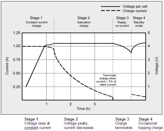

I don't agree that constant current is sufficient. There are numerous inexpensive chargers on the market that do something like below, plus adjust for temperature in real time. The cost may be comparable to a buck converters. It is the same principle, but different numbers than a 3 stage lead acid battery charger.
https://batteryuniversity.com/learn/article/charging_lithium_ion_batteries
