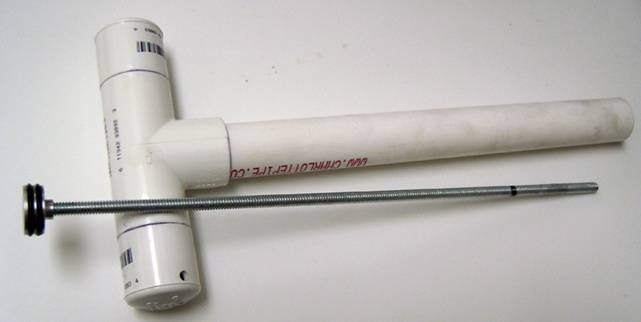

i was planning just one air tube, center lift. the led only weighs 22lbs. i will fab the lift mechanics out of aluminum (TIG is my toy). a single action air tube only needs a few small components to operate. i figure a small 12vdc air pump, a one-way valve, and a solenoid valve to do bleed down. i then allow the air tube to pressurize up to say 80psi (enough psi to lift TV to full extend), pump turns off and the two valves are closed holding the air in. after watching TV the power gets turned off, solenoid de-energizers and opens (its a NO valve, etc), then air escapes via a small orifice allowing TV to slowly return to down position via gravity. if the air tube connection develop a small leak the pump would kick back on at a defined min threshold to keep the TV in up position.
i wonder if the inside of std sched-40 PVC is smooth enough for me to make a piston that has dual o-ring. i can do CAD and i have a CNC guy who will machine for me, so i can make a piston and rod, etc. but, was 1st looking to see if COTS was available.

if i can find a small quiet air pump that can make it up to 100psi(max) (will likely only need about 50psi to lift) i think i can make the pneumatic using just a few parts. i have already sent a CAD file to my machine guy to see what it will cost to make the piston for me (dual o-ring design). i used Apple Rubber o-ring gland calculator to obtain proper dimensions of the piston for use in 3/4" sched-40 PVC. i might however switch over to ~1" aluminum tube because ID of PVC is far from being smooth or round. if the piston part only costs me say $35 i will try it on PVC to see if it will hold pressure.
well, i got my cnc'd piston today, tested it out, got well into 60lbs of force w/o blowing the seals. i only need about ~25-30lbs to lift the TV

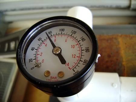

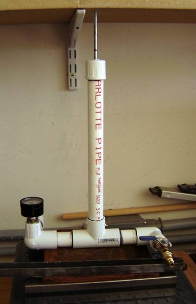

i ran test #2, to see if i can keep psi in w/o leak down. more challenging than i expected due to the threaded fittings (thank you soapy water). had to redo the threads more precisely with teflon tape and paste. the piston seems to be holding ok. its been sitting at ~75psi for last 15min or so, need to watch it over next few hrs. a very slow leak down is acceptable but hopefully i can get a few hrs of hold psi to keep the TV in up position.
math and testing is about on par with each other. 75psi with a pipe ID of ~0.800" is about 37.5lbs, my shipping scale said it was 43lbs, which falls into the range of gauge and scale inaccuracies.i think the is feasible as long as the psi can hold there. i will need to choose the peripheral components wisely to avoid dreaded leak down.
i do need to investigate further the use of Nitrile (buna-n) o-rings and PVC. nitrile and chlorinated hydrocarbons do not like each other (if my mem/chemistry serves me correctly, its the chlorine that is the issue). the cylinder is lubricated with silicone grease, but me needs to verify nitrile & pvc.

update - its been hrs and its holding at 75psi
Nice. Looks like it's going to work well.
held at 75psi for ~16hrs, until i manually let the air out.
my design so far has proven success. if i need more force in lift i can up-size the PVC and easily mod my piston CAD file to accommodate. i can likely lift any TV that is less is about 40lbs or less.
the piston design was something i have never done before, had to read a bunch about piston applications and o-ring types, then i used a o-ring groove calculator from Apple Rubber Co. using PVC can also be dicey because ID is not smooth and is way out-of-round, but under 100psi PVC seems to be ok.

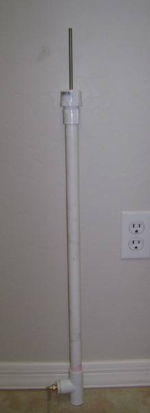

also made full scale pneumatic. a few changes. piston was redesigned to be about 1/2" taller and just a hair bigger in diameter to provide some extra stability, re-did the CAD and had my CNC guy run me 10 of them, they work great. i also switch to 304 SS rod, much better than the 1018 stuff i was using, SS rod allows me to make the rod hole in cap a 64th" smaller in dia, so some extra stability there. i know it can lift, now getting ready to build a test lift jig to see it lift some mass. i had to switch the upper cap to a 1" pvc item to make the cylinder serviceable (the piston would not fit through 3/4" fitting). in the pic the rod fully down sticks out about 3/4" with a full 24" stroke.

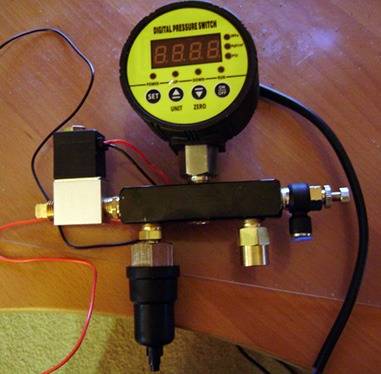

i also have the pneumatic components needed for automation, which contains a flow valve, one way input valve, a digital hi/lo controller, a safety switch, and a solenoid valve for letting the air out. all this will require 9 discrete electronic components to run (plus my inverter, batt, and batt charger). i need to test the pneumatics (2nd pic) for leak down.
arrrgghhhh! testing the pneumatics (less piston because that's already been tested) for leak down and it will not hold pressure. solenoid valve will not hold any psi, so i have to find a better item.
Are you sure you have the solenoid valve installed with the pressure connected to the "inlet" side? Most solenoid valves are pretty simple and work satisfactorily but are dependent upon the correct connections to do so..

i believe so. the valve itself has no markings but the picture the seller has of it online shows an arrow for flow from the wires side to the no-wires side. it seems like an internal leak on the inlet side because i do not get air coming out on the exit port.
You are correct, the arrow indicates the direction of flow and the inlet is on the arrow base end of the valve body. The majority of solenoid valves I have used have a (nonmagnetic) tube enclosing the actuating piston rod in the valve; so, if you are so inclined and can remove the solenoid, you can leak test the connection of that tube to the valve body for leakage (I am just trying to insure that the valve is the leak source before replacing it).
i simply bought another valve to try. it needs to be a working cots item as i don't have time to do the forensics beyond just pinning the issue down to the valve. the problem valve is a low cost MIC item shipped from china, which apparently has quality issue. i'll try new valve and hopefully that fixes my problem.
