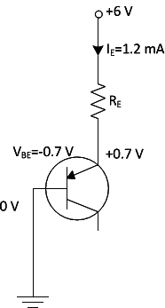

I just had arguments with my teacher about my test answer in class. I'm a little upset, but maybe I'm acting like a spoilt brat (I'll be the first to admit it) I went out and I'm using a hallway computer in my college so I can't post images. I still disagree with him-- But I'll try to explain it as best as I can.
Say I have a PNP transistor. I have a source of 6 volts. I have an unkown resistor RE, and a currect Ie = 1.2 mA. I am also told that VBE = -0.7 volts. VBE is connected to the ground.
THE FOLLOWIG IS A DRAWING OF ONLY THE LEFT SIDE OF THE CIRCUIT6 volts ----/\/\/\/\/\-------(EMITTER--->BASE)----GROUND
(the jagged lines describe the resistor RE)
Consider the right side of it (with the collector) irrelevent. Both me and my teacher did.
So, in the solution, can I just do:
Sum of all voltages= 6 - ReIe - 0.7 = 0
5.3 = 0.0012 x Re
Re = 4416.6 ohmsBUT my teacher say I should write VBE in plus in my equation! That since it's been defined as -0.7 volts, it's a mistake to write it in minus in the equationBut that doesn't make sense to me. Vbe is supposedly an electrical component, not a voltage source. There must be a voltage drop there, it can't act as a votlage source!
Please help me see the light!PS If anyone could tell me with explanation who is wrong and who is right (his explanation that it can act as a voltage source is weird to me!) he should still be in class in the next 2 hours...otherwise I'll talk to him next week

Do you mean diagram 1 or 2 in my sketch?
As you have described it the transistor would burn out.

Diagram B
As I understand your description, you have the following diagram:
Is that what you intended?
Correct ILS, plus the the fact that current Ie flows downwards from the resistor ( as it should be ) and equals 1.2 mA
Okay, okay. I added the current. :)
What about my earlier post?
I read your earlier post wholly through and replied to it. Its right under Studiot's first post
OK, taking ILS diagram now makes sense
Vbe = -O.7 means The Vb - Ve = -0.7
that is (0) - (+0.7) = -0.7
Which is as it should be.

This is about sign conventions.
VBE could be either VB - VE or VE - VB.
From your context I deduce that the sign convention your teacher is using is that:
VBE = VB - VE
With VB = 0 [V] and VE = +0.7 [V], it follows that VBE = -0.7 [V].
With this sign convention, since you already know that in your formula you need -0.7, you need to plug in VBE as "+".
And how come in NPN it is plus?
Using the same sign convention, in a similar NPN circuit you have:
VBE = VB - VE = 0.7 [V] - 0 [V] = +0.7 [V]​
That is, Vb must be higher than Ve (contrary to a PNP transistor).

You are mixing up voltages measuresd across a component with voltages appearing at particular points in the circuit.
The voltage across the base emitter is -0.7 volts (because the transistor is pnp)
but the voltage at the emitter is +0.7 volts in relation to the circuit reference.
You have to decide if you are going to use voltage drops or voltages at circuit points and then use them in a consistent manner.
Obviously the voltage drop = difference between the voltages at two points.
However we normally count this positive going up the circuit and negative going down.

ILS - in ur first post u said I was correct, now from what I read out you say I'm wrong... Originally you said I write it in plus in KVL but plug as minus... I get your voltage explanations of VBE = vb - ve ... What i don't get is how I plug it in the formula for a KVL loop where i denote the voltage drops... Up till this day, all my voltage drops were minused UNLESS it was an opposite voltage source or the current was flowing the opposite direction. I'm still confused of whether I did right or not...or whether my teacher was correct. Ill get home in 15 mins and i could use my scanner... I want to get to the bottom of this so i will be more thorough and post the original exercise with my full solution. I am on the bus with 15% iphone battery so it might die any moment. Talk to u guys soon from my headquarters
What you wrote in your opening post is all correct.
I already said it might be a misunderstanding with your teacher.

Let me be as clear as I can be, I have the scanner so let's start with the ENTIRE exercise:
http://img403.imageshack.us/img403/2739/theexercise.jpg
My full solution (and my teacher solution below it):
http://img502.imageshack.us/img502/5513/solutionstuff.jpg

Let me keep it simple: your solution is correct and what you wrote down as your teacher's proposal is wrong.

And it matches with the convention that VBE = Vb - Ve.

Your drawings in posts 21 and 25 are perfectly ok, as far as I can tell anything at all.
Thanks, maim. Studiot?
Your value for Re and analysis are correct. There is a forward voltage drop across both the emitter resistor and the emitter base junction for Kirchoff purposes.
I would not use K myself, however. Just a simple voltage divider. Then the issue would not arise.
Well done.
