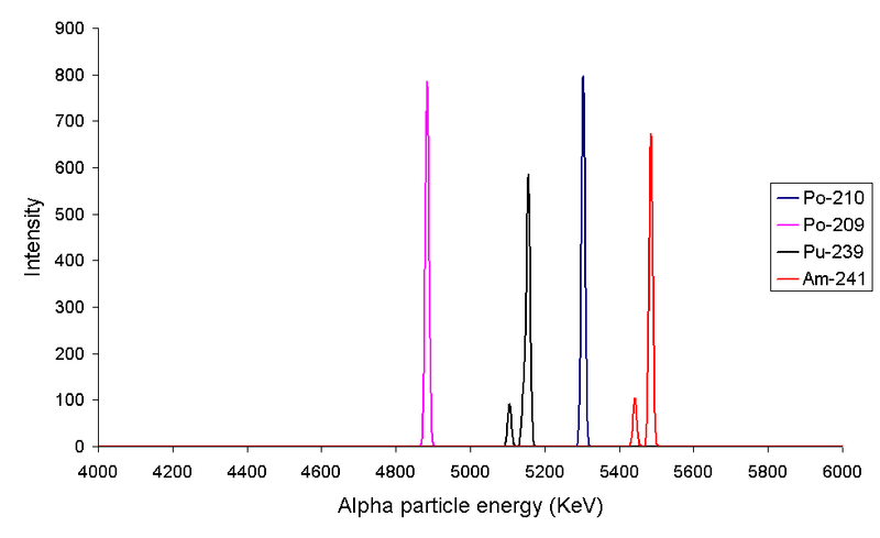

Also I would like to comment this strange statement in the Final report
...uranium 232, which has an alpha output indistinguishable from that of polonium 210
I'm very puzzled by this statement because
Po-210 emitts alpha particles with energy 5.30438 MeV
As for U-232 then as I'm aware energies of its alpha emission are
With probability 70% - 5.32024 MeV difference 15.86 KeV
With probability 30% - 5.26348 MeV difference 40.09 KeV
So U-232 produces 2 lines on the alpha spectrum while Po-210 only one. So it is highly unprofessional claim that alpha output of U-232 is 'indistingushable' from one for Po-210. What is typical energy resolution for Alpha spectrometers?
The best ones have energy resolution 11 KeV or less.
Thus Po-210 and U-232 has own quite distiguishable alpha 'fingerprints'.

Anyway, Po-210 has only one line on Alpha spectrum while U-232 has 2 lines.
Indeed, due to cause outlined by you, they are not lines exactly but rather Gaussian-shape curves (very sharp however). Po-210 would produce one such a curve but U-232 two with amplitudes in proportion 7:3 (according to probabilities of respective energies). I propose this pictue as an illustration
You might be able to get this picture in a mass-spectrometer-like environment: a few atoms in a vacuum. You will never get it with realistic biological samples.
https://radwatch.berkeley.edu/AirFilterResults has more realistic spectra. Note the width and the long tails of every peak.
Likes Sergey_KGB
