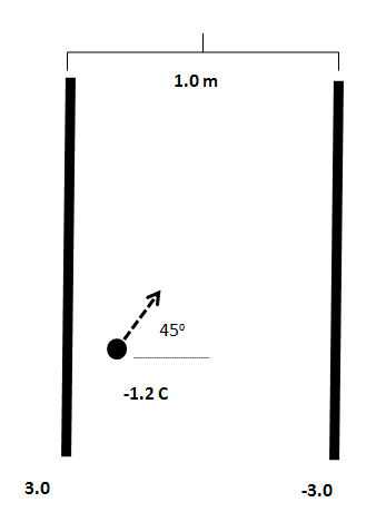

1. Homework Statement
A fixed parallel plate capacitor is charged. A point charge is starting to move with an initial speed 1.0 m/s at shown initial position. The capacitance is 5.0 F. The mass of the point charge is 0.80 kg. Assume that the plate length is infinite. No gravity. The initial distance between the charge and the positive plate is 0.3 m. The charges of the two plates are 3 C and -3C.
(a) What is the potential difference between the two plates?
(b) Draw the trajectory of the point charge on the figure given below.
(c) Find the nearest distance between the point charge and the negatively charged plate during motion.
(d) Find the largest speed of the point charge during the motion.

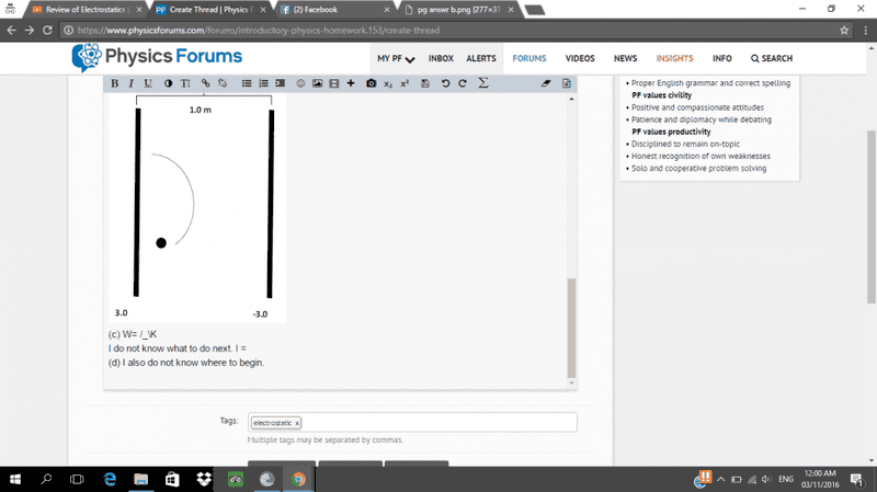

(a) /_\ (delta) v = Q/C= 3/5 = 0.6 V

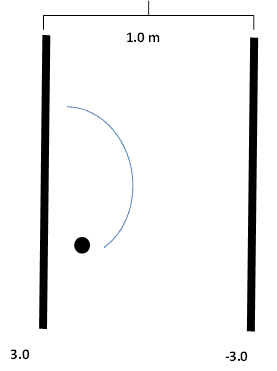

(b)
(c) W= /_\K
I do not know what to do next.
(d) I also do not know where to begin.
What is the initial distance between the charge and the positive plate? Isn't that mentioned?
It wasn't mentioned. This is a problem in our midterm that I failed to answer.

I'm sorry I just remembered it was 0.3 meters. My bad. The force on the charge would be constant I guess anywhere since the electric fields between the plates are constant.
For clarification, how is the charge on the capacitor specified? I see 3.0 and -3.0 indicated next to the plates, but no units are given. For all I know they might be nano coulombs or potentials in kV or charge densities.
A capacitor with infinite plate length and a finite capacitance is quite an achievement o_O I presume you mean to say that the plates are large enough that edge effects can be ignored so that the electric field between them is uniform?
Yes. They are in COulombs
Your electric field calculation is correct. Now, the particle is projected with some angle with respect to the plates. So it will have two components of velocity: 1) parallel to the plates and 2) perpendicular to the plates.

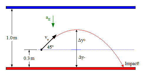

I might suggest that given the requested items, an energy approach might be expedient... You have a constant acceleration (just like gravity).

Have you studied projectile motion? This is an example of projectile motion and you can use all its formulae by replacing gravitational acceleration 'g' with the acceleration you just calculated.
cnh1995 said:
Ok.
Yes so can I use the formula that doesn't involve time?
SO is the nearest distance (y direction) at the vertex of the parabola?
So I can just plug into the formula for the maximum height?
It often helps to re-draw the problem so that it reminds you of a familiar scenario. A simple rotation of the image gives:
Likes cnh1995
Yes. But keep in mind that the particle started at 0.3m from the +ve plate. Don't forget to take it into account while calculating maximum height. Refer gneill's modified diagram.
