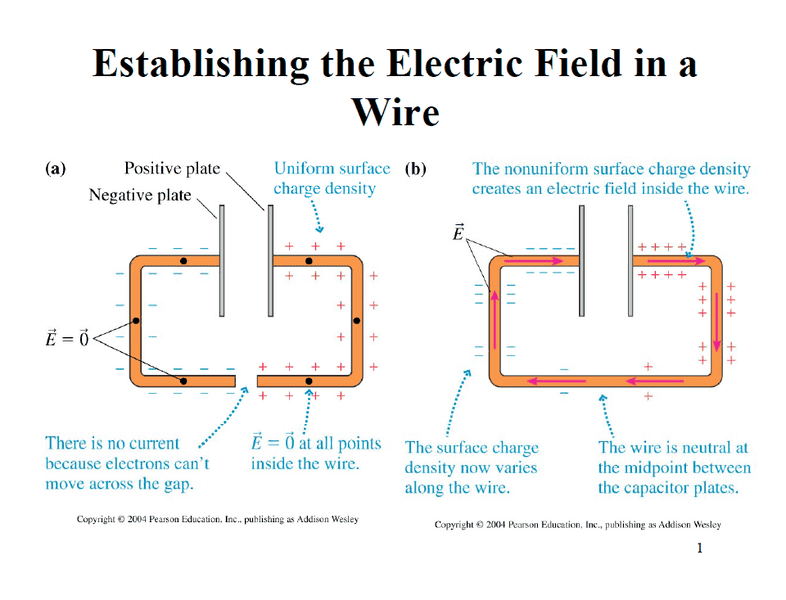

Hello , there are two questions I would like to ask from a educational paper i just read.
For the first question please look the attached picture , it says that in the picture of the capacitor with the wire that has a gap in the middle and next to it when the gap is closed , it says that in the exact middle of that wire between the two plates the wire is neutral , that would imply no charge , well first of all even if that happens , for how long as i basically see a charged capacitor being short circuited with a wire which would basically discharge the cap.
Let me rephrase the question , imagine a LC parallel tank circuit , only in the middle of the inductor cut the wire in half and place a switch in series , now charge the capacitor while the switch is open , once the capacitor is charged , close the switch , the question is for the first instant would the switch being in the middle feel any current/voltage through it ? as the current would form when the switch is closed but because going through an inductor it would build up a magnetic field which would oppose the current so at the first instant the inductor would act as a " choke" , so what happens with the switch in the middle ?
The full voltage drop of the circuit is felt across the open switch initially. After closing the switch current will flow and the voltage drop will be divided appropriately between all components in the circuit. I don't know about "the first instant".
If we assume the switch has identical resistance and is the same dimensions as the length of wire it replaced, then the inductor acts the same in both cases.

Well I guess very little to no current flows through the switch in the first instant (by instant I mean the time it takes for a certain inductor , voltage and current to produce an magnetic field in the coil)
So after you close the switch there should be a small time period at which all or most of the inrushing current is blocked due to the back emf of the coil right? After the field decreases the current starts to run but what happens at the moment and shortly before the moment of saturation that I guess is the question? As to my mind the current should be busy building up the field.
The solution to a LC circuit is given here:
http://en.wikipedia.org/wiki/LC_circuit#Solution
http://farside.ph.utexas.edu/teaching/315/Waveshtml/node5.html
You start out with a voltage across the capacitor and no current. The current increases and the voltage decreases and they oscillate in a sinusoidal pattern.
The strength of the magnetic field is irrelevant. It is the rate of change in the field that causes back EMF. That's why, initially, the current is almost totally blocked. The rate of change is very very high even though the field is very small.
