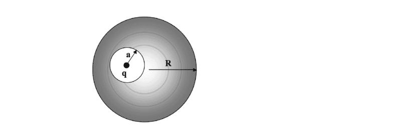

A spherical cavity (radius a) is dug out of a larger solid (neutral) conducting sphere of radius R,
see below. At the center of the cavity is a point charge q.
a)
If you move q a little off to one side, so it is no longer exactly at the center of the cavity, what changes? Please explain qualitatively and/or draw the resulting situation.
b)
Going back to the original problem (as shown), if you bring a new charge Q near the outside of the conductor,
which (if any) of your answers change? Please explain qualitatively and/or draw the resulting situation.
∫Eda=q/ϵ
For (a) this problem, the only thing I can see changing is the distribution of the negative charge on the inner wall of the cavity.
When the point charge is in the center of the cavity, you could say the induced charged is spread symmetrically on the inner cavity wall in order to oppose the point charge.
Well when we move the point charge a little off to one side, The induced charge would be more concentrated to where the the point charge is shifted to, making it lose its symmetry.
I believe the Electric Field would stay the same? If I drew a Gaussian Surface around the p.c., I should get the same E, there should still be the same #of flux passing through the surface, just one side having more lines than the other.For (b), only the outside of the conductor will be affected, mainly the distribution of the charges on the surface of the outer sphere. They will collect to repel whatever side the charge is brought near, similar to the previous problem.
The inside of the sphere, including the cavity, should be unaffected.
Am I correct?

For a), you should also discuss the induced charge distribution on the outside surface of the sphere.

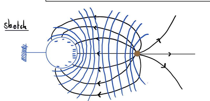

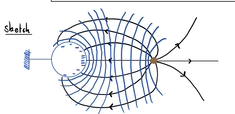

So I went over an example given in griffiths for that particular situation and barring the calculation of the potential, this is the sketch I got.
The induced charge on the neutral conductor is negative, with the charge density being concentrated on the side closest to the charge outside the conductor.
I am having a hard time seeing how that can be applied to the given case of a point charge inside this ungrounded conductor.
Sorry, I think I have blundered. I thought the method of images applied to a grounded spherical shell shows that the distribution of charges on the sphere is equivalent, as far as the field outside the sphere is concerned, to a single opposite point charge at a certain position inside the sphere.
But I now believe that is wrong. It only arranges for a zero potential at the sphere. Anyway, the rest of my argument was as follows:
From this we can see that there is a way to distribute charges on a spherical shell which, as far as the field outside the sphere is concerned, is equivalent to a single point charge at a certain position inside the sphere. In particular, that point charge can be equal and opposite to an actual charge at any given position inside a shell.
So suppose that this is how the charges on the inside of the cavity will distribute. Having done so, there is no net field outside the cavity from the point charge and the surface charge. To complete the picture we need a charge distribution on the outside of this sphere such that:
1. There is no net field in the solid region of the sphere, and
2. There is no net charge on the sphere?

For question a):
Yes the +q charge on the outside of sphere is evenly distributed.
Likes guyvsdcsniper
The electric field is a vector field. When you say it doesn't change, you're saying that at every point in space, the vector assigned to that point is the same before and after. I don't think that's what you mean.
You noted while the total flux through the gaussian surface is unchanged, there will be more field lines on one side than the other. Remember the density of field lines is greater where the electric field has greater magnitude.
Likes guyvsdcsniper and SammyS
