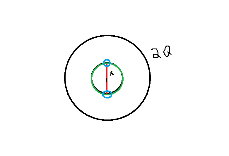

The figure represents a sphere of radius R uniformly charged with a positive charge. Inside there are two negative point charges (-Q each) placed on the same diameter of the sphere and equidistant from the center. The system is electrically neutral. Determine the distance x to which the negative charges from the center of the sphere must be for the system to be in electrostatic equilibrium.
Gauss Law
Eletric force
I traced a spherical X-ray Gaussian (green) where the negative charges were diametrically opposite. My question is this: I can transform the entire charge of the Gaussian sphere into a point charge placed in the center. So, can I analyze only the electrical forces of the two negative charges with the "new" point charge? Yes or No? And why?

Wrt equilibrium, what can move? Are the two point charges at a fixed separation, but, otherwise, everything is just floating in space?
I think both charges can move but only along a diameter. I imagine a very small hole drilled through a diameter of the sphere with the two charges inside it. One is looking for the equilibrium separation between the charges.
Likes jbriggs444 and Delta2
Yes, that's at least as reasonable a reading. But neither makes it a very interesting problem, or am I missing something? The sphere must be an insulator since we are told the charge is uniformly distributed.
You cannot replace the two point charges with an equivalent charge at their midpoint. There is no such equivalency.
The shell theorem allows you to treat a uniformly charged shell (and, consequently, any collection of concentric uniformly charged shells) as if the charge were concentrated in the center. Two identical point charges by themselves do not comprise a uniformly charged shell.
You do have a uniformly charged spherical volume at hand. The equivalence would be valid for it. Be careful about the caveat for how the equivalency works for the effect on objects inside versus objects outside.
I think you are asking whether or not you can replace the system by the three charges shown on the right in the picture below.
As helpers, we're not allowed to just give you the answer. From your studies can you come up with an argument for why this simplification to three point charges is valid or not valid?

I’ll chip in. I believe the original question should be something like this:
A uniformly charged solid sphere [not a shell] of radius R has total charge +2Q.
Two point charges, each -Q, are [somehow] inserted so that they are on opposite sides of a diameter, each a distance x from the centre (x<R).
Find x such that the net force on each point charge is zero.
Based on this (without showing the few lines of working needed) I get x = R/2.
