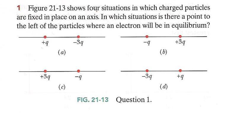

See figure attached for problem statement.
I'm a little confused on how to start on this one.
Okay so I know that the two particles with oppsite charge attract one another, and a 3q force of attraction is going to be larger than a -q force of attraction.(and vice versa)
So is it in cases (c) and (d) that an electron will find its point of equilibrium to the left of the particles?
Not always. What else does the force of attraction depend on?
The distance between the two charges?
Yes. Now combine those two factors to see which arrangements can meet the criteria.
I'm still not seeing how to do that. Can you give me another nudge?
EDIT: The forces on each other should be 0 in equilibrium so we're looking at the following,
[tex]F = k \frac{1*3}{r^{2}}[/tex]
Now in some scenarios,
[tex]\vec{F_{ab}} = k \frac{1*3}{r^{2}} \hat{i}[/tex]
and in others
[tex]\vec{F_{ab}} = - k \frac{1*3}{r^{2}} \hat{i}[/tex]
Sure. In order for the net force on the electron to be zero, what must be the relative size of F_1 and F_2? In which configurations is that not possible?
Are we to assume that the electron has a charge of -1q?
How do we know what force and electron will have on the given particles?
That doesn't matter. (But you can assume that if you like.)
All we care about is the net force on the electron. Compare the force on the electron from each of the two charges. Hint: In some cases the force from one charge will always be greater than the force from the other, for an electron placed to the left.
Ah I see it now, it can only be done in cases a and b!
Right!
