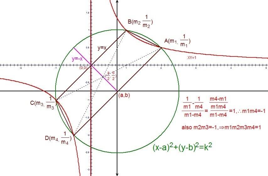

I never said that circle has centre at origin
I know you will question this ,it does not matter where the centre locate
if the origin translate from (0,0) to (a,b),all ther points will also translate relatively ,and the result will not change
it matters because shifting (0,0) to (a,b) changes $(m_r,\frac{1}{m_r})$ to $(a + m_r,b + \frac{1}{m_r})$ no longer reciprocals
View the diagram:
Albert said:
View the diagram:
Albert, please attach your images here in the challenges forum inline so they can be hidden within the spoiler, and not show up as an attachment, outside of the spoiler defeating the purpose of using the spoiler tags. This can easily be done by using the "Insert Image" tool on our toolbar. :)
