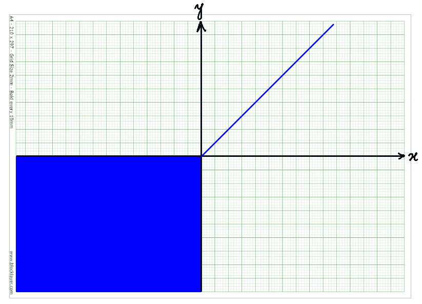

I plot the graph alongside for the solution and regions.

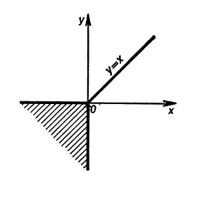

On the left is the solution from the book.
Though my answer looks correct, is the reasoning alright?
