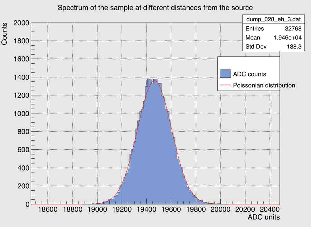

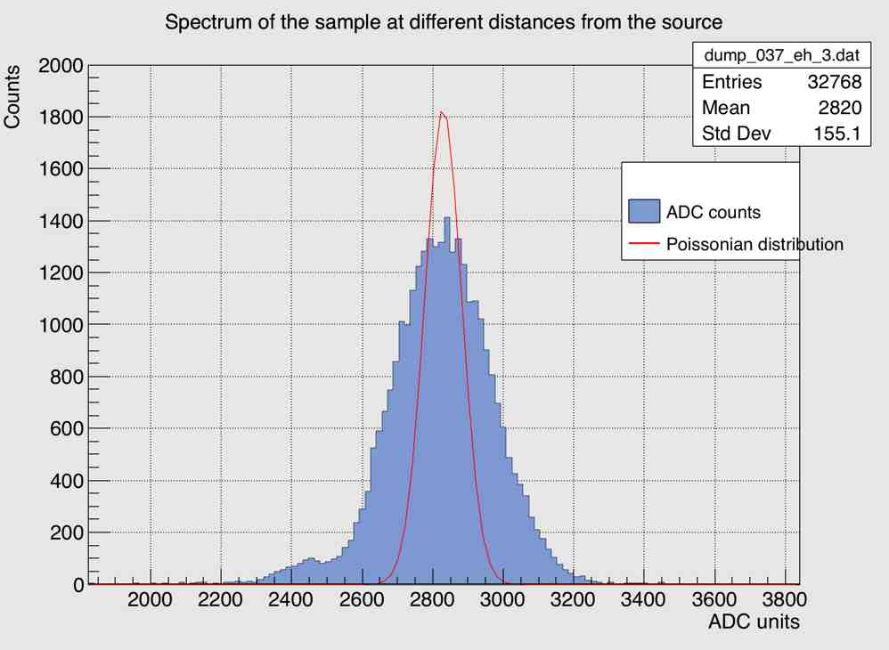

Sometimes I see a Poisson distribution, sometimes I do not, I don't understand why
My setup:
I have the an LED (LED370E) in front of a photodiode (S12915-16R). The photodiode is connected to an ADC (DT5751) which has a counting functionality. The way it works is that it counts how many times the signal goes above a certain threshold and makes a histogram out of it.
I know that photons often follow Poissonian Distributions, but I am aware that Super and Sub poissonian light also exists.
The mark of a Poissonian distribution is that sigma^2 = mean, so I made Poissonian distributions with the same mean as the measurements from the ADC. Here is how 2 of them look like:
The difference between these two measurements is that the one on the left was taken with the LED at 6.5 volts, and the one on the right at 2.5.
First thing I don't understand: why does one fit the Poissonian distribution and the other doesn't?, what kind of noise is affecting my measurement?.
Second things I don't understand: I have read in https://camera.hamamatsu.com/jp/en/technical_guides/photon_shot_noise/index.html that the Shot Noise is equal to the square root of the signal. Is the Shot Noise the same as the Standard Deviation?, is Shot Noise = Sigma?.
LED voltage is fixed by semiconductor material bandgap in eV that decides wavelength. E = h * u.
LED light output is proportional to LED current, NOT voltage. You must identify LED current.
LED current must be controlled. Maybe you have a series resistor in the circuit.
You are measuring the spectrum of noise peaks on the continuous photodiode current. That is not shot noise.

The LED had a resistance of 50 Ohms, so the current would be just Voltage/50. If current is proportional to voltage, the LED output would be proportional too, right?.

I measured the spectrum of the LED, it was 358.6 instead of 370 nm

I mean that the power supply has a built in resistance of 50 Ohms for anything you connect to it
With 6.5 volts and 50 ohms in series, you would have been driving more than the rated current through the LED.
The scales seem similar, but 2.5 volts is insufficient to generate any significant forward current through that LED.
You need to know and understand each module of your equipment before you take measurements.
