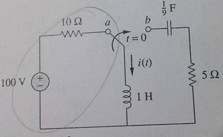

In the figure given, the switch was at position A for a long time, at time =0 the switch is turned to position B...
My question is how do we assume the polarities for both the resistor and the capacitor after the switch is in position B
I know that a time t = 0, the current at the inductor is 1A and will be moving in a clockwise direction, and as current moves from higher potential to lower potential meaning that the the upper side of the inductor will be its positive terminal and the lower side will be its negative...
What about the resistor and capacitor??
Since in they are connected in series won't they have the opposite sign of the element which leads/ follows them...
As in the lower terminal of the resistor will be positive
the upper terminal of the resistor will be negative
the right terminal of the capacitor will be positive
the left terminal of the capacitor will be negative
Is this correct??

How did you determine the direction of the current in the inductor for time t=0?
Assuming that it reached steady state when the switch was in position A, the current through the inductor was 1A and going downwards

Right. So when the switch moves to position b, what direction will it be going?

Okay, the part I have difficulty with in the above is the assignment of a polarity to the inductor for time t = 0 (or really, t = 0-). At steady state there will be no potential across the inductor; it will behave as a short circuit.
At time t = 0+, the inductor will develop a potential across it in order to maintain the current flow with the same magnitude and direction it had the instant before the switch commutation. So you can assign a polarity to that potential accordingly.

Usually they can be assigned by the direction of the current flow: The "+" end of the component will be the terminal that the current enters. Things can be a bit trickier with energy-storing components such as inductors and capacitors, since they can be the source for a current or hold a potential previously stored there. In this case the inductor is going to develop a potential that will drive the current, so you should be able to figure out which end of that potential difference has to be positive in order to do so. The capacitor is initially uncharged so it will end up building a potential difference with a certain polarity depending upon the current starting at t=0.
Don't confuse these "dynamic" polarity assignments with any pre-existing labels on the circuit diagram that are there to tell you how to interpret various potentials in the circuit.
As it turns out, the following of potential polarity assignments are fine:
Thank you sir much appreciated
