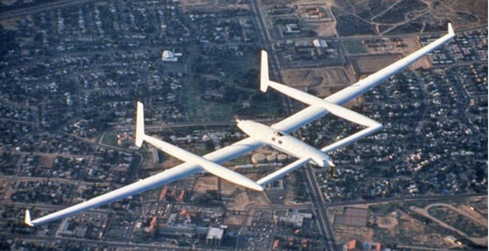

They make airplanes from it. One famous example is the Rutan Voyager, the first airplane to fly around the world nonstop without air to air refueling. Photo below from NASA:
Fiber reinforced composites can be made in quantities of one, or in mass production. The manufacturing techniques are different for mass production than for small quantities.
There are plastics that can be bought in sheet form, sawed to size, then heat bent into shape. Polycarbonate, as mentioned above, is a good choice to start with. You would need to run a test to find if it is strong enough.
If it works for planes I'm sure this will work for my application. However, I like the idea of working with polycarbonate sheets. Will a standard heat gun be enough to heat and form it to shape? Does the heating process change the properties or strength of the polycarbonate?

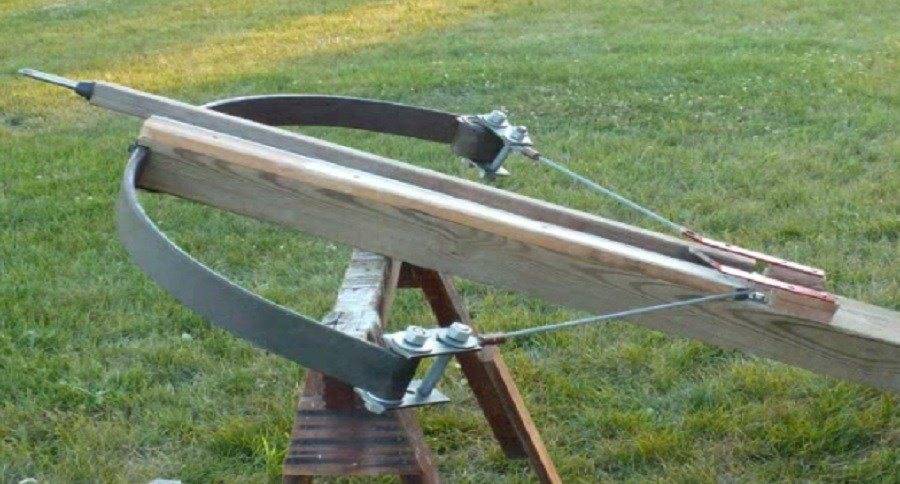

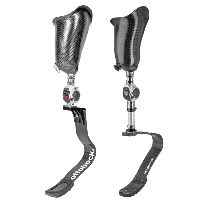

Bows for hunting has been made out of wood for thousands of years. And if they did not spring back they will not function...
Modern compound bow limbs are made from glass fiber / epoxy composites and a lot of leg prosthetics like the ones pictured above is made from carbon fiber / epoxy composites.
But for ease of manufacture and low cost high volume production i wold think that a fiber reinforced thermoplastic will be a better option. But i don't know if it has the same properties as the fiber reinforced epoxy materials mentioned above.
Any of them made from spring steel?
Yes bows can be made with leaf springs. But it will be really heavy.
Yeah, I should have been specific. I was talking about long bows, not cross bows, which I did realize had been made w/ steel.
