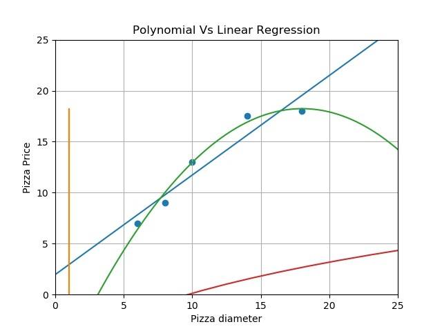

In summary, the book shows two curves, but the code generated four. The figure attached shows the original three and the fourth curve which was generated when the line plt.plot(xx, yy_quadratic) was commented out.

I followed an example in a book that compares polynomial regression with linear regression. We have one feature or explanatory variable. The code is the following:
Code:
import numpy as np
import matplotlib.pyplot as plt
from sklearn.linear_model import LinearRegression
from sklearn.preprocessing import PolynomialFeatures
X_train = np.array([6, 8, 10, 14, 18]).reshape(-1, 1)
Y_train = np.array([7, 9, 13, 17.5, 18])
X_test = np.array([6, 8, 11, 16]).reshape(-1, 1)
Y_test = np.array([8, 12, 15, 18])
regressor_linear = LinearRegression()
regressor_linear.fit(X_train, Y_train)
xx = np.linspace(0, 25, 100)
yy = regressor_linear.predict(xx.reshape(xx.shape[0], 1))
plt.plot(xx, yy)
quadratic_featurizer = PolynomialFeatures(degree = 2)
X_train_quadratic = quadratic_featurizer.fit_transform(X_train)
X_test_quadratic = quadratic_featurizer.transform(X_test)
regressor_quadratic = LinearRegression()
regressor_quadratic.fit(X_train_quadratic, Y_train)
xx_quadratic = quadratic_featurizer.transform(xx.reshape(xx.shape[0], 1))
yy_quadratic = regressor_quadratic.predict(xx_quadratic)
print(xx_quadratic)
plt.plot(xx_quadratic, yy_quadratic)
plt.title("Polynomial Vs Linear Regression")
plt.xlabel("Pizza diameter")
plt.ylabel("Pizza Price")
plt.scatter(X_train, Y_train)
plt.axis([0, 25, 0, 25])
plt.grid(True)
plt.show()
However, the figure (attached) shows 4 curves not just two. Why? In the book it shows just two.

Are you asking why the vertical line segment (gold) and the sloped segment (red) are plotted? I suspect it's due to the line plt.plot(xx, yy). You could test this by commenting that line out and seeing whether those two lines go away.
Likes EngWiPy
Yes, I meant the gold and red ones. They appear along with the green one due to the following line
Code:
Commenting the above line removes the three mentioned curves. But why do I have 2 extra curves?
OK, I discovered my mistake. I must plot
Code:
and not
Code:
The new figure is attached.
Thanks
