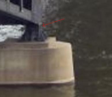

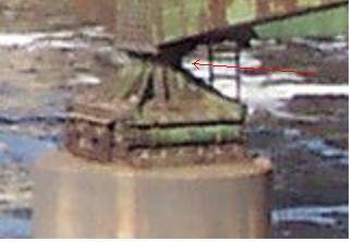

This mentions other truss type bridges in Minnesota that have been
ordered to be inspected in the wake of the I-35W collapse. Note that
all of these do have supports within the river.
The page also has close-up images before the collapse of the bridge
supports, suspected as being where the failure occurred. Notice the
joints connecting the steel beams to the concrete supports in the next
to last image on this page. Why are these joints so tiny on the top?
It's almost like they are coming to a point? This clearly would result
in a greater deal of pressure on this portion of the joint, like the
pressure placed at the bottom of stiletto heels.
Compare to the width at the top of the joints of the DeSoto bridge, a
similar truss type bridge, in the next to last image here:
Desoto Bridge
Mississippi River Highway Crossing
St. Cloud, MN
http://www.visi.com/~jweeks/headwaters/pages03/mn23desoto.html
I'ved attached zoomed in images of the I-35W and Desoto bridge joints below.
Bob Clark

The I35W bridge was not a steel arch, it was a three span steel truss bridge.
Yes, it would, and there is nothing wrong with that. In fact, it is done on purpose for flexibility. If you bolt them, they can't flex and that creates a tremendous amount of stress.
