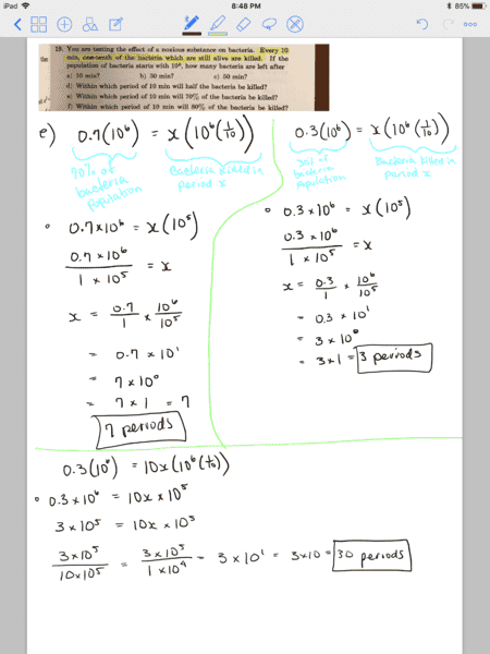

1. Homework Statement
You’re testing the effect of a noxious substance on bacteria. Every 10 minutes, one-tenth of the bacteria which are still alive are killed. If the population of bacteria starts with 10^6, within which period of 10 minutes will 70% of the bacteria be killed?
N/A
I tried three different ways to solve, which are all on the attached image (seemed more effective to post that so you can see my reasoning). I’d just like to know if my equation set up is incorrect or if my calculations are incorrect. Each of the three attempts is in its own box. I know I’m wrong on all three, as the solution from the book says 110-120 minutes.
The equation setup is incorrect. It looks like you are using ##x## for the number of periods. Then ##x## must be an exponent, not something that just multiplies other numbers.
To get you started, think about this: What proportion of the original bacteria is left after 20 minutes?
Now what about after 20 minutes?
Now what about 30 minutes?
With luck you will see the pattern and get the correct formula.

Ok thanks for the responses.
Here's the reasoning that I had:
We start with a factor of 10^6, and every period of 10 minutes, that gets cut by 1/10.
So by the second period, period 2, I figured it to look like 2(10^6(1/10)), meaning that the process of cutting the 10^6 by 1/10 happened a second time (hence the 2 for period 2).
By your reasoning, in what proportion of the bacteria is left after 20 minutes, 30 minutes, etc: are we saying we are taking 1/10th of 1/10th of 10^6, or rather 10^6(1/10)^2?

What are you using k as? The period?
Here's what I think makes the most sense if I've understood correctly.
##0.7\left(10^6\right)=\left(10^6\left(\frac{1}{10}\right)\right)^x##
In words,
LHS: 70% of the starting population of 10^6 bacteria
RHS: The decay process of 10^6(1/10) happening x times.
That formula won't give the correct answer because it is raising the population (##10^6## bacteria) as well as the attrition factor (##1/10##) to the power ##x##. Dimensional Analysis is helpful in avoiding such errors. We want each side of the equation to give a number of bacteria. Given the ##10^6## has units 'bacteria' (ie number of bacteria), the LHS of your equation has units 'bacteria' on the left, but units
'bacteria##{}^6## ' on the RHS. Since the units do not match, the equation cannot be correct.

So in reading all of your posts, I want to say the appropriate equation would be:
$$0.3\left(10^6\right)=10^6\left(\frac{1}{10}\right)^x$$
With this, the LHS would represent 30% of the initial population, and the RHS would represent the initial population multiplied by the "decay" factor.
This seems correct, but I don't want to say that it is because the section of the book hasn't gone over solving for variable exponents yet. Thoughts?
Take another look at post #8.
If you have decay occurring, exponentially, and you KEEP 90% after each time increment, then your model would or could be done as y=p(0.9)^x. Now with this, if you want to decay from 100% to 30%, then you setup the values in the model like this:
0.3=(0.9)^x
Be reminded, x is how many increments of 10 minutes each. (Or did I completely misread, and you are keeping 10% after each time increment?)
If the model I listed here is what you need, then you could apply x at 1, 2, 3, 4, 5, etcetra and see during which increment you get your "0.3".
You can also solve the equation for x, which you will certainly be learning, probably about now...
So you're saying replace (1/10) with (0.9) because the 1/10 represents what's killed off, and the 0.9 represents what's left? So we would have ##0.3\left(10^6\right)=10^6\left(0.9\right)^x##?
Not sure why this problem is giving me so much gruff. Thanks for the help.

Here is what you wrote as the description in post #1:
Now, if x is the counting of the ten-minute increments, y is living bacteria after x time, p is amount of bacteria at time x=0, you should be able to read ( and maybe reread) the description and form the exponential relationship and choose the correct base for the x.
One-tenth of the bacteria is killed after each ten-minute time increment. So what fraction then still lives?
Every ten minutes, a tenth of the bacteria are KILLED.
At 10 minutes: a tenth of 10^6 bacteria are killed. This leaves 100,000 remaining.
At 20 minutes : a tenth of the 100,000 bacteria are killed. This leaves 10,000 remaining.
At 30 minutes: a tenth of the 10,000 are killed. This leaves 1000 remaining.
This is the process that is happening.
Now I am asked at which period will 70% of the bacteria be killed, or 30% of the bacteria remain?
The initial population of the bacteria is 10^6. I want to find 30% of 10^6. Mathematically, I want 0.3(10^6). This is one side of the equation, where I list what I am asked for.
For the other side, I express the process of decay that is happening, which I listed in words previously.
I know that I am given an initial population of 10^6, and every ten minutes, the current population drops by a tenth, or (1/10).
To express this process mathematically, I have the given population dropping by a tenth every ten minutes, or 10^6(1/10)(1/10)(1/10)... or 10^6(1/10)^x.
So combining both of these, I have ##0.3\left(10^6\right)=10^6\left(\frac{1}{10}\right)^x##
This is my train of thought here, looking at it as bacteria killed. The LHS represents 30% of the initial bacteria population, which means 70% was killed. The RHS represents the decay process. Could you be so kind as to highlight in bold where I make a faulty statement?
