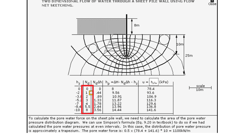

I am not sure how to get Nd in this question ( circled part)
I am not sure the exact location of the point where the author want to find the pore pressure .
Can someone help ? This notes is confusing
I think the Nd can be only in whole number , so the 5.5 is definitely wrong .
Can someone point out the exact location of the point please ? Or i misunderstood something here ?
