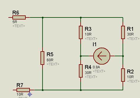

Title says it all. Question is attached.
Simple KCLs, KVLs etc
What I don't get is that isn't [tex]I_{R_{4}} = \frac{R_{3}}{R_{3}+R_{4}} * I1[/tex]
This expression is for a current divider. It would be valid if R3 and R4 were in parallel, which they are not.
Write Kirchoff's equations for the 3 loops to obtain the voltages on the terminals of R4 and R2. The voltage on the source is the difference between them.
