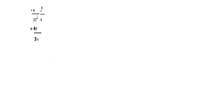

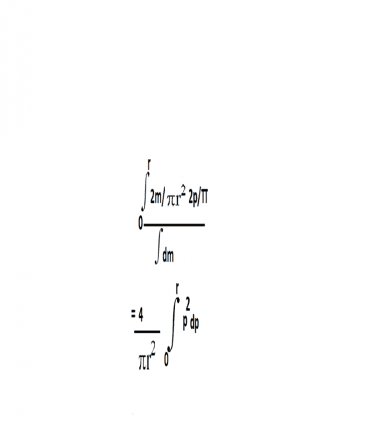

My teacher taught us how to locate position of centre of mass in semicircular disc
She said circular disc is made up of two semicircles .It's centre of mass is located in centre .But When one of the semicircles is taken out from the circle , only one semicircle is left out.To locate the semicircular's centre of mass she taught us the following method
we will have to take help of calculus or of integration to be more precise .We should choose small semicircular ring of radius "p'and of thickness 'dp'.Total mass of that semicircular disc is given to be "m" and radius "r" so To detect position of centre of mass of semicircular disc we will use following formula
y coordinate of centre of mass=∫mass of that small semicircular ring multiplied by Y coordinate of it's centre of mass/∫dm(mass of that small semicircular ring )
Now mass of the small ring would be equal mass per unit area multiplied by area of ring i.e 2m/π r^2 multiplied by circumference by thickness i.e πp dp.Y coordinate of the ring can be treated as Y coordinate of it's centre of mass .In one of our derivations Y coordinate of semicircular ring came out to be 2 multiplied by it's radius/π
So y coordinate of centre of mass=∫2m/π r^2 multiplied by πp dp ×2pπ/ ∫dm an integration has upper and lower limit of r and zero respectively because we want to take all possible small rings of "0" to "r" radius.
So centre of mass of semicircular disc will be 4r/3 pi vertical distance from origin.I understood all these except how thickness comes out to be dp?How thickness can be derivative of radius(dR)?

You perform the operations on the variable inside the integral sign, but the answer emerges in terms of the limits. In this case, p is the dummy variable inside the integral but the limits are in terms of r, so the answer is in term of r.
You confuse the radius of the semicircular disc which is r which is a constant, with the dynamic variable p which represents the position of the infinitesimal circular disc positioned at distance p from the center and spanning the semicircular region between distance p and p+dp. I know it will be hard to understand what i am saying without drawing a diagram or a figure but i believe that's where the problem lies anyway. Did your teacher provide a figure that shows the whole thing. if yes look at it carefully again.

Ok the video is good, what is it that u don't understand then? thickness is dp and it shows at the figure why is that. It is like having a rectangle with one side 2πp and the other side dp. Maybe you confused with the semantics of thickness, we don't mean thickness in the z-dimension, but thickness in the radial dimension.

From a mathematical point of view, you have the notion of "Integral of a (measurable) function on a (differentiable) manifold" and the "center of mass" of your semi-disk is just a particular case:
## D := (0,R)\times(0,\pi) ## (in polar coordinates) and
## \vec{r}_{CM} :=\frac{\int_D \rho(r,\theta)(x(r,\theta), y(r, \theta) ) |J(r,\theta)| drd\theta}{M}##
if the semi-disk is homogeneous:
## \vec{r}_{CM} :=\frac{\int_D \rho(r,\theta)(x(r,\theta), y(r, \theta) ) |J(r,\theta)| drd\theta}{M} = \frac{\int_0 ^{\pi}\left(\int_0^R\rho (r cos(\theta), r sin(\theta) ) r dr\right)d\theta}{M} =####=\frac{\rho\int_0 ^{\pi}\left(\int_0^R (r^2 cos(\theta), r^2 sin(\theta) ) dr\right)d\theta}{M} = \frac{\rho\int_0^{\pi}(cos(\theta)[\frac{r^3}{3}]_0^R , sin(\theta) [\frac{r^3}{3}]_0^R ) d\theta}{M}=####=\frac{\rho R^3 \int_0^{\pi} (cos(\theta), sin(\theta) ) d\theta}{3 M}= \frac{\rho R^3 ( [sin(\theta)]_0^{\pi}, [-cos(\theta)]_0^{\pi})}{3 M}=####=\frac{\rho R^3}{3 M} (0,2)=\frac{M}{\pi R^2/2}\frac{ R^3}{3 M}(0,2)= \frac{2 R}{3 \pi} (0, 2) = ( 0, \frac{4 R}{3 \pi} )##To be able to undertand the formula
or in general (integral of measurable functions on differentiable manifolds)
you should study Calculus on Manifolds.
