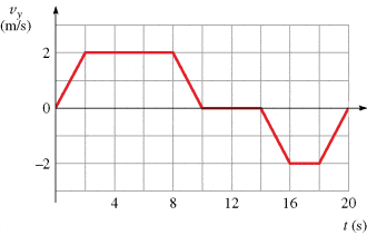

You are consulting for an elevator company. During a safety test, technicians created the following graph of the velocity of the elevator versus time; you have been asked to interpret the graph. Unfortunately, you are told that the technician who printed the graph has made two mistakes. The labeled interval on the velocity axis should be 2.1 m/s rather than 2.0 m/s, and the labeled time interval should be 4.2 s rather than 4.0 s. You should begin by redrawing the graph on your own paper with the proper labels on the velocity and time axes.
Since this motion is purely one-dimensional, give your answers to the following questions using a coordinate system consisting of a y-axis in the Up-Down direction with Up as positive. Indicate directions by the appropriate plus or minus sign. Assume that the test begins (at time zero) with the elevator at position y0=-3.1 m (i.e. 3.1 meters below ground level -- ground level has been selected as the location at which y=0).

##v = Δy/Δt## (y is the variable in this case)
What is the position of the elevator at time 2.1 seconds? ... 8.4 seconds? ... etc.
##v = 2.1\ m/s = \frac{y_f - (-3.1\ m)}{2.1\ s - 0\ s}##
##\Delta y = 4.41\ m = y_f + 3.1\ m##
##y_f = 1.31\ m##

(why are your time increments 2.1 and not 4.2 ? :confused:)
it's difficult to tell without seeing the graph,
but i'll guess that the experiment started with he lift stationary for 2.1s, so that y2.1 is still 0 :smile:

I'll make a different guess - that the graph shows a straight line from (0, 0) to (2, 4) (or whatever). If so, it underwent uniform acceleration for that time period.
That formula would be right if 2.1 m/s were the average velocity for the first 2.1 s, but you are given it as the instantaneous velocity at the end of the first time period. If its speed increased uniformly from rest over that time, what was its average speed?

I've attached the given graph (didn't know how before).

From the lecture, the average speed is: $$average\ speed = \frac{d}{\Delta t}$$ where ##d## is distance traveled, and ##\Delta t## is the time elapsed. So how would I find the distance traveled?
From the data that I've been given and the data that I've calculated previously, I'm a little lost as to where to go from here...
##velocity\ @\ t = 2.1\ s \rightarrow 2.1\ m/s##
##\Delta t = 2.1\ s##
##y_0 = -3.1\ m##
have you been taught about distance = area under the velocity graph?
(if not, forget i said it)
This is it!
##position\ @\ t = 2.1\ s \rightarrow -3.1\ m + \frac{2.1\ s * 2.1\ m/s}{2} = -0.895\ m##
Quite so, and that is always valid.
As I guessed, the graph shows uniform acceleration from t=0 to t=2.1 (i.e. a straight line on the velocity-time graph). It follows that the average speed vavg is the average of the initial and final speeds, (0+2.1)/2 = 1.05m/s. So you can use these two equations to find the distance traveled: d = vavg*Δt = 1.05*2.1. Note that taking the average of the initial and final speeds is only valid for constant acceleration. You should also be able to see how this relates to areas on the graph.
