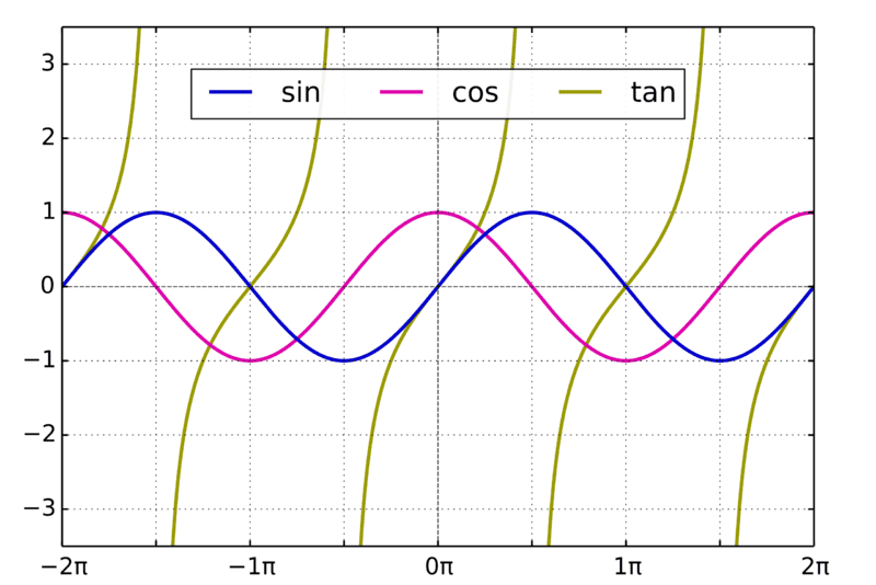

The first thing I did when seeing your thread start today was to try to visualize the motion expressed by that equation. So that pretty quickly led me to the non-standard starting point.
IMO, it's good to get in the habit of visualizing the motion expressed by an equation when you first see it. It gets easier as you do it more and more often, and helps to get your mind right for working the rest of the problem. :smile:
Edit/Add -- Part of being able to visualize something like this quickly is to have memorized what sin and cos functions look like, especially around zero as an argument, and how that relates to motion around the unit circle.

Thank you for your help @berkeman ! Good idea to try to visualize the motion.
