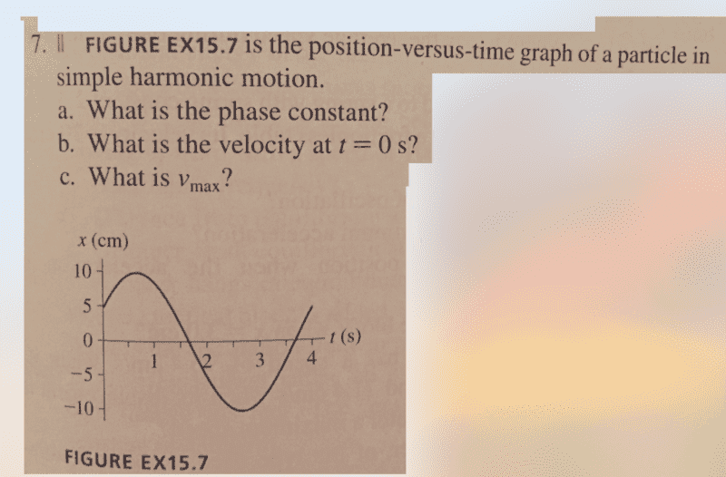

[see attached photo]
I seek specific help with (a) only. The answers to this question are provided in the back of the textbook, so I know the answers (I hope).
##x(t)=Acos(\omega t+\phi _{0}),##
##v_{x}(t)=-A\omega sin(\omega t+\phi _{0})=-v_{max}sin(\omega t+\phi _{0}),##
##v_{max}=\frac{2\pi A}{T}##
For (b), I got ##v_{x}(0)=13.6 \frac{cm}{s}##
For (c), I got ##v_{max}=15.7 \frac{cm}{s}##
Both of these answers are correct, according to the back of the textbook
For (a) (the phase constant), however, the back of the book says the correct answer is ##\phi _{0}=-\frac{2\pi}{3}##
I got: ##\frac{1}{2}A=Acos(\phi _{0})\Rightarrow cos^{-1}(\frac{1}{2})=\phi _{0}=\pm \frac{\pi}{3}##, for which I got ##-\frac{\pi}{3}## since it's moving to the right at ##t=0 s##
With this answer, I was able to acquire the right answers for (b) and (c). Furthermore, I was able to accurately graph the same graph provided in the text using my answer, but not so with the answer given in the textbook. I'm lost, really. Can someone please help point something out that I'm missing?

I agree with your solution. As a check, if we go 1/6 of a wavelength to the right of the origin we hit the peak. cos(π/3-π/3)=cos(0)=1.
Arguably one can show equivalence between ## cos(ωt-π/3) ## and ## -sin(ωt-2π/3) ##

The standard seems to be the cos form. It certainly appears that this is what the OP has been taught.

Yes. Anyway I think I've got that wrong - too used to working in degrees! $$cos(ωt-π/3) = sin(5π/6-ωt)=-sin(ωt-5π/6)$$

Sure, but in order to define the phase you need to know which is to be used.

In essence a cos graph is essentially a sin graph left shifted ## π/2 ## radians. Thus we may right the following equivalences:
$$ cos(wt + ∅) = sin(wt + ∅ + π/2) $$ and $$ sin(ωt + ∅)=cos(ωt+∅-π/2) $$
