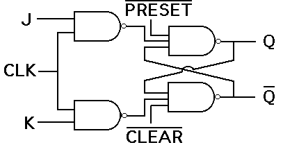

Hi guys,
I'm simulating a circuit which uses a few (actually, 10) Positive-Edge-Triggered JK flip flops.
The exact flip-flop design that I'm using is the SN7476 from TI. I need a flip-flop like this, since I need Preset and Clear asynchronous inputs. The datasheet is as follows:
http://www.ti.com/lit/ds/symlink/sn7476.pdf
In fact, as I'm simulating a circuit with MOS only transistors, I found an adaptation for this circuit on the following link:
http://tams-www.informatik.uni-hamb...16-flipflops/40-jkff/SN7476-single_print.html which simplifies my circuit a little bit.
As I use it for simulation, I'd like to use a simpler version of this flip-flop, to speed up the process (at this moment, my focus is not the design, I just need to make things faster.)
Is there an alternative for this circuit which uses a lower number of transistors?
I know this is an Master/Slave flip-flop. I tried to inplement an equivalent circuit using this topology: http://2.bp.blogspot.com/-fxhp4O9oDEo/UGH4G6SSF8I/AAAAAAAAAJ0/ueUKXx0-Eew/s1600/jkffcirc.gif as well as this one http://wearcam.org/ece385/lectureflipflops/flipflops/fig6a.gif with the additional preset/clear signals, but it didn't work as expected.
Is there any equivalent popular IC to SN7476? I know that SN7476 is "obsolete", so I took a look at NXP's 74LVC109, but the number of gates goes beyond what I need right now.
Any ideas?
Thank you in advance.

It's an old design for a control logic of an ADC. It was proposed on 1972. They proposed a version using D flip flops, which uses 2N+2 DFFs and a version with JK with N+1 FFs. Of course it was targeted to LSI/MSI applications.
I did some calculations, and found out that the JK version requires 540 transistors (using the 7476 topology), while the D version requires 648 (using 7474). My simulations show that, because of this, the JK version is much faster.
These simulations take a lot of time. My goal right now is to speed up the process a little bit more...
The point is: I don't care exactly about the flip-flop type right now, but the number of transistors they use...
Thank you.

Like I said before (in other words), the good old 7474 ( http://home.gwi.net/~pstewart/7474diag.gif ) uses 6 nand3 gates (which in cmos would require 36 transistors).
For the design I'm using, despite the higher number of transistors/flip-flop, it's still a better trade-off in terms of transistor count.
But thank you for your suggestion.

Not building exactly, just designing. I'm free to use custom flip-flops. I just used the ones that the paper suggested.
Take a look at: http://ipnpr.jpl.nasa.gov/progress_report2/XIII/XIIIW.PDF
p. 5 shows the classical approach with D flip flops and p. 9 shows the alternative one with JK FFs
I added a link to my previous post while you were replying.
http://electronics.stackexchange.com...e-of-the-clock shows a 10 transistor d-flop
BTW, You can add transistors (logic) to the basic 10 transistor D flop to get JK functionality. I'll let you play with that.
