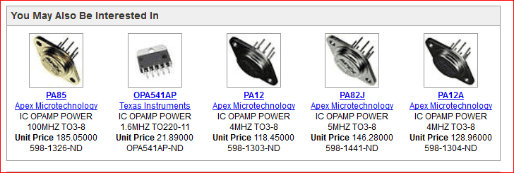

Look up the cost of an operational amplifier with just the few milliamps of drive capability that you might use for the active filter in a pre-amplification crossover.
TI's wonderful OPA1641 is capable of 20 milliamps (maybe 30 of you push it) and costs three or four bucks in single quantity at Mouser.
http://www.ti.com/product/OPA1641?keyMatch=audio opamp&tisearch=Search-EN-Everything
A three band preamp crossover will take maybe twelve dollars worth of those opamps.
To drive a speaker requires a lot more current.
Last high power opamps i bought were LM12's, good for 6 AMPS not milliamps, cost around seventy five bucks apiece and you'd want to bridge connect them two per speaker .. So a three way post amp crossover would take maybe four hundred fifty dollars worth of opamps at 1995 prices.
My old workhorse LM12 is obsolete now , cheapest i could find online was over three hundred bucks apiece.
High power linears are still expensive, multiply any of these prices by 6..
But, there are some audiophiles who would love it. You just might find a market.
