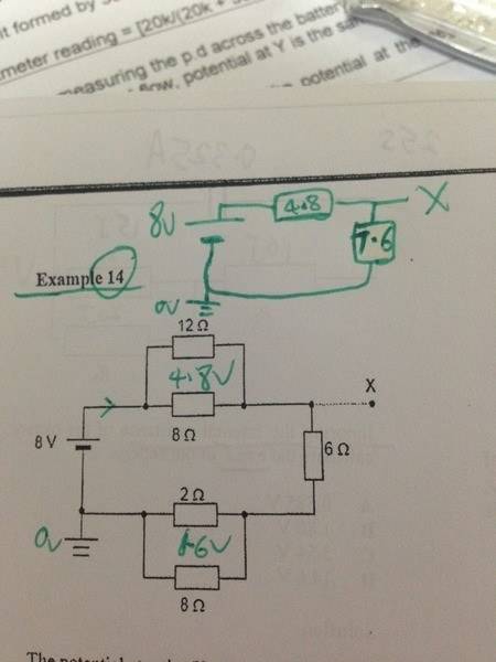

Why is the potential at X , denoted by V, not
V/8 = 4.8/(4.8+7.6) ? Why is numerator of resistance part 7.6 and not 4.8 by potential divider principle?
hi vadevalor! :smile:
conventionally, the current flows from the positive terminal (long line) to the negative terminal (short line)
(the electrons, of course go the other way, towards the positive!)
so the short line is at zero potential, and you have to start from the short line to get to X to find the potential at X, ie the potential difference from zero
(see eg "Electric Potential Diagrams" at http://www.physicsclassroom.com/class/circuits/u9l1c.cfm)
ie you go through the 7.6Ω, so 7.6 is in the numerator :wink:
The values 4.8V and 1.6V shown on the circuit diagram are misleading. Should not the unit be Ω instead of V?
The equivalent circuit is a voltage supply of 8V connected to 4.8Ω in series with 7.6Ω as shown correctly in your diagram.
Hence 8V is the voltage on (4.8 + 7.6)Ω.
And the voltage on 4.8Ω can be found be using direct proportion.
Thank you all for your inputs! I realized its the direction after thinking for so long. And yea it should be ohm instead of v.

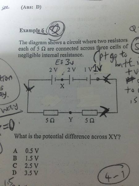

I have another question regarding potential could you guys help me? Answer is A but i don't understand the solution as there are 'conflicting battery direction' and i don't know how to start
Thanks!
- curious lost soul
start by replacing the three batteries by one 3V battery …
what is the potential at Y? and where is that measured from?
and now adjust that to start from X instead :wink:

Should i put the 3v battery to the right or left of X and should i go from + terminal to -terminal from X to Y like current flow or electron flow?

you must always always ALWAYS use current flow not electron flow!
X is somewhere in the middle of the 3V battery, isn't it? :wink:

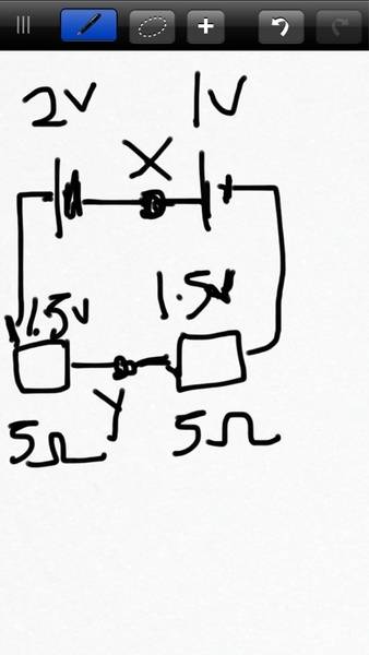

Think i got it! Yes! So its 2-1.5= 0.5v following current direction. But when do i know to use current or electron flow direction? Above for potential divider i was told to look at electron flow
yes, i like your diagram …
you've split the batteries into two: a 2V and a 2 minus 1 = 1V battery going the same way,
so it's easy to see whether to add or subtract :smile:
