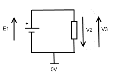

Even if the 0V node was specified the polarity of the voltages isn't defined. Consider this circuit...
If E1 = 10V then V3 = 10V and V2 = -10V. See how the polarity depends on the direction of the arrow I drew on the circuit.
So I would argue that in your circuit all of the following are valid answers...
V1=+q/c1 and V2=+q/c2
V1=-q/c1 and V2=+q/c2
V1=+q/c1 and V2=-q/c2
V1=-q/c1, and V2=-q/c2
