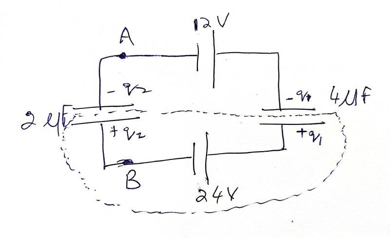

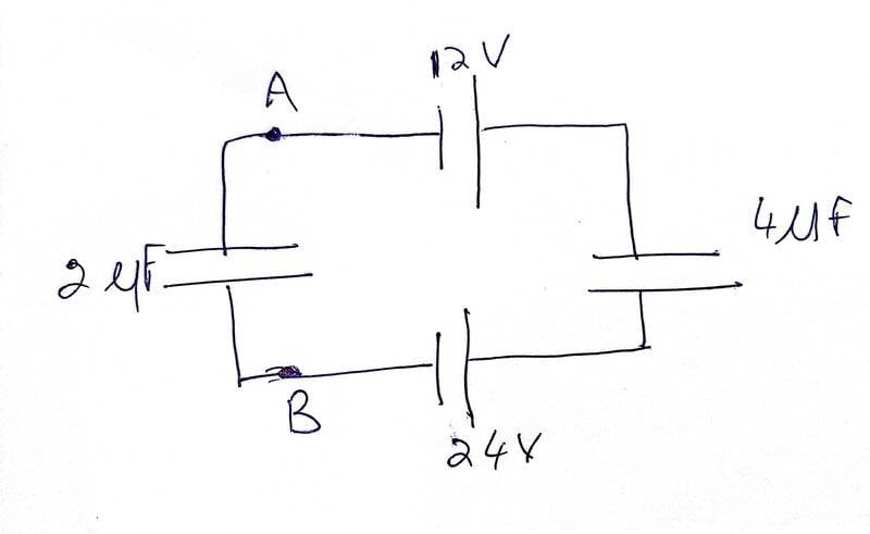

What is the potential difference between points A and B in the circuit below.
##C= \dfrac {q}{V}##
Sum of potential rises = Sum of potential drops in a circuit loop
In the given circuit, a transient current will flow and when this current finally stops at equilibrium, the charges ##q_1## and ##q_2## are assumed to deposit at the capacitor plates as shown below. The dashed line indicates an isolated system that will have it's total charge conserved.
If I assume ##V_1## and ##V_2## as the potential differences across the 4 ##\mu F##and 2 ##\mu F## at equilibrium state, then the following equations are true.
##2 \times 10^{-6}V_2 = q_2##
##4 \times 10^{-6}V_1 = q_1##
I need two more equations, since there are 4 unknowns. One of the equations can be obtained by applying law of conservation of charge to the isolated system within the dashed curve, for which we can say total charge at start = total charge when circuit reaches equilibrium i.e. ##0 = q_1 + q_2##; but in the isolated system there is the 24 V battery whose terminals will also have charges when equilibrium is reached. My question is whether I can assume the battery terminals to have equal and opposite charges when not delivering current?

I don't understand what you mean by this. You can assume that the potential difference across each battery is fixed at ##\mathcal{E}_1=##12 V and ##\mathcal{E}_2=2\mathcal{E}_1=##24 V. Then start at point A and go to B adding potential drops/rises clockwise and counterclockwise. That should give you two equations. The charge conservation equation is a third equation. You don't need a fourth. Write something down and see what you get. I would do everything in symbolic form before substituting numbers.

I see. When applying conservation of charge to the isolated system within the dashed line, we will get (charge on lower plate of left capacitor + charge on lower plate of right capacitor + charge on postive terminal of 24 V battery + charge on negative terminal of 24 V battery) = 0.
Equation when going anticlockwise from A to B is ## V_b-V_a = V_2## and when going clockwise ##V_b-V_a = 12 +V_1 -24##. These two equations can be combined into one equation ## V_2 = 12 +V_1 -24##.
We have the following unknowns: ##q_1##, ##q_2##, ##V_1## and ##V_2##. Since, there are 4 unknowns, shouldn't we need a total of 4 equations?

And what are ##V_1## and ##V_2## in terms of ##q_1##, ##C_1=2C=~##4 μF, ##q_2## and ##C_2=C=~##2 μF? Please use only symbols for your answers. No numbers.
Likes vcsharp2003
##V_1= \dfrac {q_1} {2C}##
##V_2=\dfrac {q_2} {C}##
So what happens when you put all this in your equations in post #3?

##\dfrac {q_2}{C} = \dfrac {q_1}{2C} -12##
Another equation relating the charges ##q_1## and ##q_2## is needed using law of conservation of charges applied to the isolated system.
No numbers please. I assume you meant to say
##\dfrac {q_2}{C} = \dfrac {q_1}{2C} -\mathcal{E}##.
OK now remember that you are looking for ##V_b-V_a=\dfrac{q_2}{C}##. What happens if at this point you use the charge continuity equation?

One of the equations can be obtained by applying law of conservation of charge to the isolated system within the dashed curve, for which we can say total charge at start = total charge when circuit reaches equilibrium i.e. ##0=q_1+q_2##;

Shouldn't we also consider the charge on +ve and -ve terminals of the battery when applying charge conservation to the isolated system I showed in OP?

My answer to that is "No", not for this introductory physics problem.

In effect, @vcsharp2003 is asking whether the batteries might have initial net charges. If they were to have such, that would invalidate your solution in post #2.
So the short answer is that you can assume they do not.

It is because the default state for these ideal circuit problems is that all elements are neutrally charged when the circuit is put together. Of course, if there is an explicit statement that an element, e.g. a capacitor, is initially charged then you have to go by that. Here there is no such statement.

Not at all. I didn't write that the terminals were uncharged; I wrote that the battery has no net charge.

If the battery were allowed to have an unknown net charge the problem could not be solved. Consider the limiting case of the voltage being zero, but the battery having a net charge Q. On connection, potential differences will arise in the capacitors.
This, it seems to me, is the essence of the OP's question in post #1; for my answer see post #17.
