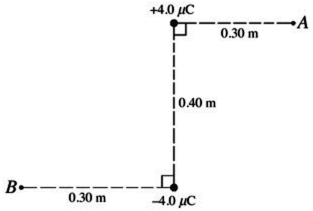

A +4.0 μC-point charge and a -4.0 μC point charge are placed as shown in the figure. What is the potential difference, V_A - V_B, between points A and B? (k = 1/4πε_0 = 8.99 × 10^9 N · m^2/C^2)
https://www.physicsforums.com/attac...2/?temp_hash=fc256c7e6e7317423fc360366b1c7272
V = (k*q)/r
Point B is 0.30 m away from the -4.0 μC point charge. The potential there is (9*10^9*-4*10^(-6))/(.3) = -120,000 V.
Point A is 0.30 m away from the 4.0 μC point charge. The potential there is (9*10^9*4*10^(-6))/(.3) = 120,000 V.
So I thought I could do V_A - V_B = 120,000V - (-120,000V) = 240,000V but that doesn't work.
Help please? Thanks.
The point here is to create the algebraic sum of potential differences between points A and B. So, what about between the two charges?
Likes qlzlahs
You need to account for the potentials due to both charges at both locations. So for example the potential at point A is due to the effects of both the 4 μC charge and the -4 μC charge combined.
Likes qlzlahs
So the potential at A is:
(9*10^9*4*10^(-6))/(.3) + (9*10^9*-4*10^(-6))/(.5) = 48,000 V
and the potential at B is:
(9*10^9*-4*10^(-6))/(.3) + (9*10^9*4*10^(-6))/(.5) = -48,000 V
V_a - V_b = 96,000 V?
That looks better.
Thanks! Got it.
