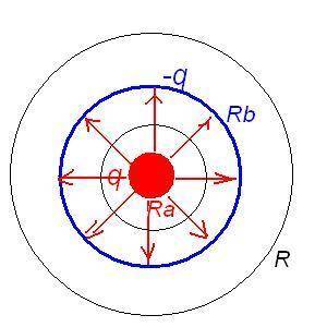

A capacitor made of a round solid bar and a thin round tube are coaxial, they are very long. the radii of the bar is ra and of the tube rb. they are both charged with λ, the charge per unit length, with opposite charges. what is the potential difference.

If you have problems with charged metal objects, like in this problem, the distribution of charges on the surfaces are influenced by the geometry of the set-up. In symmetric cases, it is easier if you determine the electric field , using Gauss' Law and integrate it to obtain the potential.
Look at the picture. In case of a single tube, the surface charge is on the outer surface. If the bar is placed in the middle, the charge of the tube is on the inner surface.
Draw a Gaussian cylinder around the tube. The charge inside is zero, as the tube and the bar have equal and opposite charges. The electric field outside the cylinder is zero.
So
##V(R) - V(Ro) = -\int_{Ro}^R Edr = 0 ##.
The potential is constant. You can choose that potential equal to zero. (Ro can be at infinity, where it is naturally zero.
V(R)=V(Ro)=0) .That is true at Rb, too, so V(Rb) = 0.
Between the inner bar and the inner surface of tube the Gaussian cylinder encloses q charge. The electric field is
##E(R)=\frac{q}{\varepsilon 2\pi R L }##.
If the wall of the tube is very thin the radius of the inner surface is also Rb. As we know the potential there, we integrate from Rb to R to get the potential between Ra and Rb.
##V(R) - V(Rb) = -\int_{Rb}^R Edr = - \frac{q}{\varepsilon 2\pi L }\int_{Rb}^R (\frac{1}{r}dr)= \frac{q}{\varepsilon 2\pi L } \log( \frac {Rb}{R})##
The potential inside the metal bar is also constant and is equal to the potential at Ra.
As V(Rb)=0, the potential function is
V(R)=0 if R≥Rb;
##V(R)=\frac{q}{\varepsilon 2\pi L } \log( \frac {Rb}{R}) ## if Ra ≤ R≤ Rb;
##V(R)=\frac{q}{\varepsilon 2\pi L } \log( \frac {Rb}{Ra}) ## if R≤Ra.
