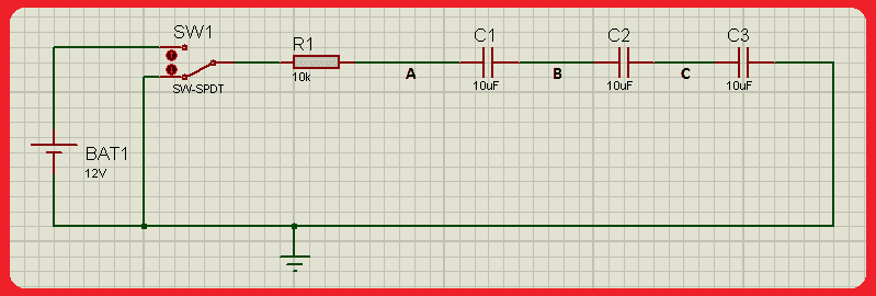

Hi,
I'm having a problem with this circuit finding potential difference between capacitors. I know the answers by playing around on simulation software A=12v B=8v and C=4v however, I am struggling to use the formula provided Vc= (Vt/Ct)*C to find the answers. It works fine in a parallel circuit with components of the same value but I know that series is different.
1. Homework Statement
Using the formula Vc = (Vt / Ct) * C
  1. Calculate the voltage at A when SW1 is switched to 12V. 12V (v= I x R)
  2. Calculate the voltage at B when SW1 is switched to 12V. 8V
  3. Calculate the voltage at C when SW1 is switched to 12V. 4V
I have worked out Question A using ohms law- not the formula provided just to check against simulation software.
So far I understand that VC will be A, B, C
Vt is voltage total=12v
Ct is capacitance total 1/ct=1/c1+1/c2+1/c3 =3.3 recurring
vt/ct=3.6
Now I'm struggling to understand what I times 3.6 by to make either 4, 8 and 12 finishing the formula.
Can anyone help me please?
Thanks

I suspect that you may be mistaken in the formula that you're using.
For a capacitance C the relationship between the charge and voltage on it is given by
Q = CV
Now, in your case you've calculated a net capacitance Ct and you have a voltage Vt = 12V placed across it. What is the charge on that capacitance?
Next, what do you recall about how charges are distributed between capacitors in series?

Ware182 said:
so I can work out the charge for C1 by 10x10-6 x 12 = 120uC however I don't know how to apply that in a way to find the potential difference.
No, the full 12V is not across every capacitor. The full 12V is across the total equivalent capacitance that you found, Ct. So you can find the charge on THAT capacitance.
Now, this is where my question about how charge is distributed amongst capacitors in series becomes critical. You need to know how this works! Since all components that are series connected always share the same current, any change in charge on capacitors in series must be identical. So if the charge on your equivalent capacitor Ct is Q, every one of the series capacitors that make up Ct has the same charge Q.
If you know the charge on a capacitor then you can find the voltage across that capacitor via Q = CV.
In this case you find the charge Q on Ct, then apply that charge to each of the capacitors that make up Ct to find their individual voltages.

ok so I've spent all day on it and I think I've finally got it.
1/10 +1/10 + 1/10 = 0.3
1/0.3 = 3.3 recurring
Qt = 3.3 recurring * 12 = 40
40/10 = 4 (4V drop across each capacitor)
40/10 + 40/10 +40/10 = 12V (Applying Kirchoff's law to check)
can you confirm that this is the way you were trying to show me
Yes, that's the method.
Try to remember to attach units to results, even intermediate step results. That or work symbolically until the very end where you can plug in numbers. It's much easier to spot errors with variables than amongst a sea of numbers.
Thanks for all your help. that's good advice I'll be sure to apply that.
