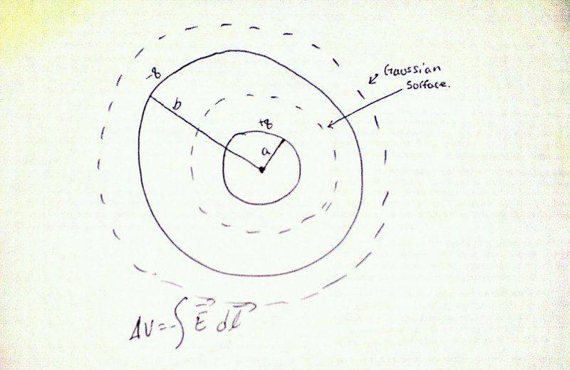

Two concentric conducting spherical shells have equal and opposite charges. The inner shell has outer radius [itex]a[/itex] and charge [itex]+q[/itex]; the outer shell has inner radius [itex]b[/itex] and charge [itex]-q[/itex]. Find the potential difference [itex]V_{a}-V_{b}[/itex] between the shells
My professor said to in order to solve this, integrate the electric field to find the electric potential...
[itex]\Delta V = -\int\stackrel{\rightarrow}{E}dl[/itex]
My question is, using Gauss's Law, ([itex]\oint E_{n}dA = \frac{Q}{\epsilon}[/itex]), how do I go about finding Q?
Isn't Q just the charge of the shell?
In Gauss's law, Q is the charge enclosed by your Gaussian surface. So, first decide where you Gaussian surface will be, then add up all the charge inside of it.
HINT: You want your surface to be in the region where you want to find the electric field.

This is what I have drawn (see attachment). Is the basic idea here to integrate the electric field of the outer Gaussian surface from b to a? If so, what about the inner Gaussian surface?

You want to find the potential difference between the shells, so you don't need the Gaussian surface outside the larger shell.
Try this: Take your inner surface and place it at an arbitrary point r. Then, find E using the standard approach when using Gauss's law. You will then have E between the plates as a function of r. Can you use that to find the potential difference between the plates?
