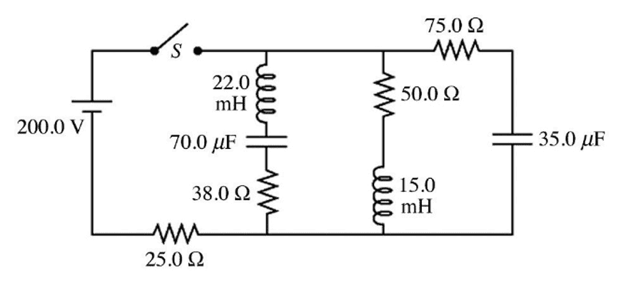

1) For the circuit shown in the figure, the switch has been open for a very long time.
(a) What is the potential drop across the 15.0-mH inductor just after closing the switch?
ε = L*(di/dt)
V_R = iR
At t=0, I believe that the current is instantaneously 0 Amps. If that is correct, then technically at that instant there is no voltage drop across any of the resistors due to Ohm's Law. So I replaced the resistors with wire. Next, I tried replacing all of the capacitors with open circuits to simplify everything further. When I did that, there was only one closed loop for the current to travel through, and that's the loop with my 15-mH inductor. But that's where I'm getting lost.
My only other thought is that I need to use the equation ε = L*(di/dt) but there are two unknowns. I want to find ε for the 15 mH inductor, but I don't know di/dt.
Based on what, precisely ?
You have a voltage source with an internal resistance of 25 ##\Omega## and three branches. From left to right LCR, RL and RC.
It is certainly not correct for the rightmost branch. Check RC circuit under: Time considerations. The capacitor will instantaneously start charging with a current of 1 A. And the 75 ##\Omega## and 25 ##\Omega## will have a voltage drop of 150 V and 50 V, respectively
That's not an argument ! The capacitors are uncharged and if they are connected to a voltage source, they start charging to the tune of ##\displaystyle{I = C{dV\over dt}}\ ##. I.e. instantaneously they are short-circuits, not open circuits !
Now check RL circuits under : Time considerations and try again.
Truman I said:
Homework Statement:: 1) For the circuit shown in the figure, the switch has been open for a very long time.
Relevant Equations:: ε = L*(di/dt)
V_R = iR
The current where? Remember that the 35 μF capacitor is initially uncharged and as soon as the switch is closed it acts as a "short". Redraw the circuit taking that into account.
Yeah I definitely had a misconception about current there. So at t=0, the 75 ohm and 25 ohm resistors act like they are in series. 150 Volts will drop across the 75 ohm resistor (Ohm's Law). Therefore, because the 15-mH Inductor is in parallel with the 75 ohm resistor, there will also be a potential difference of 150 volts.
Is that logic correct?
That looks about right.
Awesome, thanks for the help!
