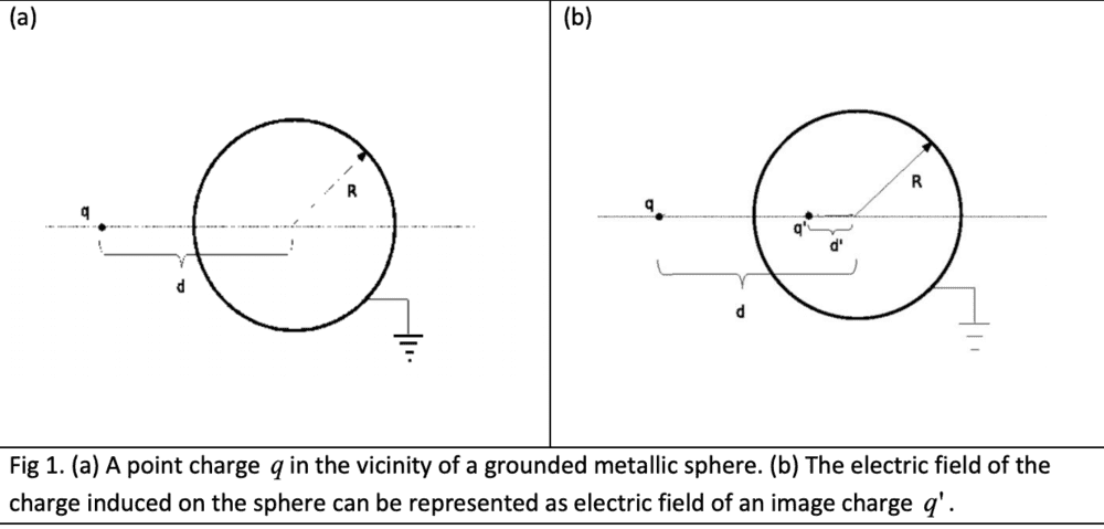

In terms of the external charge q, radius of the sphere R and the distance d (distance between external charge and centre of sphere)
determine the following electrostatic energies:
a) the electrostatic energy of the interaction between charge q and the induced
charges on the sphere;
b) the electrostatic energy of the interaction among the induced charges on the
sphere;
c) the total electrostatic energy of the interaction in the system.
Method of image charges gives the following:
The metal sphere can be replaced with a charge q' = -q* R/d,
at a distance
d' = R^2/d from the centre of the sphere.
Energy can be found by integrating -Fdx.
Let us attempt part C first, which is to find the total energy of the entire system.
I can definitely find an expression for the force, as given by Coulomb's Law. However, why should I integrate this force from infinity to d, where d is the distance of the external charge to the centre of the sphere?
I was thinking that the upper limit of the integration should be d - d', which is the distance between the external charge and the image charge. OR, If you consider the limiting case where R --> infinity, the external charge is effectively facing a flat plate, and so the upper limit of integration should be d - R. Why is this wrong?
For part (a), the electrostatic energy between the external charge and the induced charges is apparently just the energy between the external charge and the image charge, as given by kqq'/(d-d'). Why is this true? Aren't the formulas for energy inapplicable for regions within the sphere, as the image charge only replicates conditions outside the sphere?
Any help would be greatly appreciated. Thank you!
I assume you mean the force between the point charge and the sphere, or, equivalently, between the point charge and the image charge.
But be careful here: as you integrate wrt movement of the point charge, are you keeping the image charge constant or allowing that to move and weaken in response to the movement of the point charge?

The upper limit will depend on the choice of the variable that you use to express the force. If you choose the origin at the center of the sphere and let ##x## be the distance of the charge ##q## from the origin, then you can express the force on ##q## in terms of ##x##. You can then find the work for moving ##q## from infinity to the final position by letting the limits of integration be infinity and the final value of ##x##. How is the final value of ##x## related to ##d## as defined in the problem?

the force is kqq’/(d-d’)^2, as given by Coulomb’s law. This can be expanded out to be kq^2Rd/(d^2 - R^2)^2. I suppose in this case, when integrating wrt “x”, “x” is taken with origin at the centre, since the original formula for the force has the length d, which is the distance of the external charge to the centre of the sphere.
However, why can’t I simply redefine the axes, such that the origin is now at the image charge? Wouldn’t the expression for the force remain the same, except now I am integrating from infinity to a distance d - d’, thus giving a different result? Thank you.

Yes. Both ##x## and ##d## are locating the charge ##q## relative to the center of the sphere. Think of ##d## as representing the particular value of ##x## for which you want to calculate the potential energies (as shown in the figure). So, for an arbitrary value of ##x##, the force may be expressed as a function of ##x## as ##F(x) =kq^2Rx/(x^2 - R^2)^2##. What would be the value of ##x## for the upper limit of integration when finding the work done by ##F(x)## in going from infinity to the position of ##q## shown in the figure?
I'm not following how you are going to do this. As you move the charge ##q## from infinity to the position shown in the figure, the position of the image charge ##q'## will also move. Are you taking your origin to move with the movement of ##q'##, or are you taking your origin to be fixed at the specific location of ##q'## as shown in the figure? Either way, can you show explicitly how you would set up the integral for either of these choices?

Eh? Imagining it moving to infinity is how you calculate the PE.
As you quoted,
The metal sphere can be replaced with a charge q' = -q* R/d, at a distance d' = R^2/d from the centre of the sphere.
If you actually move the point charge to infinity, integrating the force as you go, the point will also move, and change in charge. What will the force be when the point charge is at distance x from the sphere's centre?

Thank you for this. This idea of image charges is very new to me, so I was not aware that the image charge also moves. I now see that because the point charge also moves, it is important that we define the force with respect to a fixed displacement from a fixed axis, which can be taken to be the centre of the sphere. The point charge is not fixed, and thus cannot be taken as a fixed axis. Thus, using the formulas for the charge and distance of the image charge, a force integral with constant terms, apart from the distance to centre of sphere, can be set up.
