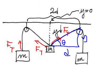

Find the potential energy function for the three mass, earth, and pulley system as shown. The potential energy will be as a function of the vertical position downward as shown in the diagram. Also, find the equilibrium position of this system. The two outside masses are equal.

How is the center mass supported?

Supported? By the 2 tension forces of the 2 outer blocks upward. But that would be internal

Yeessss ... and to left and right ... a "sling" ... need any help resolving the forces?

I think what you're supposed to realize here is that the tension forces are doing work on the three masses, but since your system is everything, work = 0, and so you have to express that as a potential energy... so in a sense, you're trying to find TPE (tension potential energy).
It is; there is only one angle for which the vertical components of the forces balance/are balanced.

Ok, so I took your hint, and found that angle that would yield the equilibrium position, aka forces balance, and accel = 0.
using that angle, I found the y position that would yielf equilibrium.
I labeled the mass in the middle as m1 and the masses on the outside as m2.
F = ma System m2
There is a tension force up, and a gravity force down on m2. accel is 0 because it's in equilibrium. Take up to be positive.
Ft - Fg = 0
Ft = m2 * g
F = ma System m1
There are 2 equal tension forces angle (#) (<- i'll just write my theta as #) above the horizontal, and a gravity force down. accel = 0; in equilibrium. Up positive.
2Ft sin(#) - Fg = 0
2 (m2 * g) sin(#) = m1 * g
sin(#) = (1/2) m1/m2
(#) = sin^(-1) (m1/(2*m2))
So, in the diagram, it says that the 2 outer masses are a distance 2d apart, so the horizontal distance between m1 and either m2 is d.
tan(#) = y/d
so y = d * tan( sin^(-1) (m1/(2*m2)))
is this correct?
Edit: for clarity, this is what I'm seeing:
So if all my work is correct, I've solved the 2nd part of the problem.
But I'm still not sure how to solve the first part of the problem, which is finding the potential energy as a function of y...
Well.. I found the angle of the tension forces to be arcTan(mg / 2D). So therefore, the equilibrium position would be... D tan(theta). Would this be correct?
You need the potential energy of the three-mass system, in the gravitational field of the Earth, in terms of y, position of the middle mass, assuming symmetric arrangement, when the position of the other masses are determined by y.
How would the potential energy change if you move the middle block downward by Δy?

I meant the total potential energy of the whole system. How do the potential energies the other two blocks change if the middle block goes downward by Δy?
