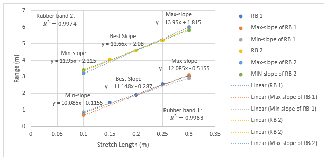

Ohh i see thank you so much for your reply, however it only applies for non-linear? but my graph is linear... is there any other way to get the potential energy for linear relationship?
rasalzari said:
my graph is linear
What graph? What values are you plotting on the axes?
haruspex said:
Interesting.
What are the values of x2-x0 for each band?
