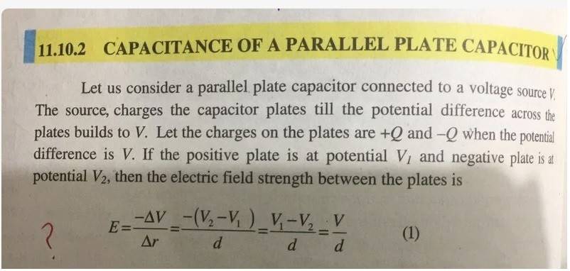

HOWEVER, for parallel plate (capacitors) the potential gradient is defined as E = V/d (V being the potential difference). How come there's no negative sign for the potential gradient of the parallel plates?
My book derives it as follows: E = -V/r, but V=V2-V1 (V2 being the lower potential), so E=-(V2-V1)/r and -(V2-V1) = V1-V2, which is the potential difference and r = d, so E = V/d.
HOW? How did they even equate V = V2-V1, when V is just electric potential, fixed for a specific point in space.

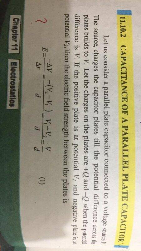

Alright, I know I'm being a bit of a bother here, but this is what's written in my book.
Does this make any sense, what-so-ever, at all, to you?
ALSO, I'm not really comprehending what this relation even means. If you consider a potential gradient of a point charge, you'd say it is the rate of change of electric potential w.r.t the distance a test charge covers. Perfectly understandable as the distance covered would either be from infinity to a point within an electric field or vice versa. It represents the electric field between the point in infinity and the point in the electric field.
BUT, when it comes to the potential gradient due to two parallel plates, what does E = -V/d represent? What does it EXPLAIN? I'm not really at that stage where I can understand calculus in physics, so pls do pretend that I'm an 8 year old xD

Here are my own two bits of wisdom. The textbook description is poorly written and it is small wonder why @ZEROBRAINCAPACITANCE is confused. One reads
##"##Let the charges on the plates are (sic) ##+Q## and ##-Q## when the potential difference is ##V##. If the positive plate is at potential ##V_1## and the negative plate is at potential ##V_2##, then the electric field strength between plates is $$E=\frac{-\Delta V}{\Delta r}=\frac{-(V_2-V_1)}{d}=\frac{(V_1-V_2)}{d} = \frac{V}{d}"$$What I consider confusing:
1. The opening sentence calls the potential difference ##V## when the symbol is also used to denote electrostatic potential in the equation below (##V_1,~V_2##). Furthermore, the starting potential difference ##\Delta V## is transformed to what is apparently electric potential ##V## or is that the difference as originally stated?
2. A difference, denoted by the symbol ##\Delta##, is defined as "What comes later minus what comes earlier". When time is the independent variable, that is easy to figure out. With distance ##r## one has to define first which way ##r## is increasing and then take the difference accordingly. Here, nothing is said about the direction of increasing ##r##. ##\Delta r## is replaced with a positive quantity ##d##, but for taking the difference in the numerator how does that explain the choice ##(V_1-V_2)## in the numerator? Why not the other way around?
How to fix it:
Far be it for me to rewrite this textbook but here it is
"In this particular case, we are looking for the strength (magnitude) of the electric field, a positive quantity. Thus, we write $$E=\left |\frac{\Delta V}{\Delta r}\right|=\frac{V}{d}.$$Note: Symbol ##V## has two uses: (a) to denote electrostatic potential in which case it is a function of position, e.g. ##V(r)=\frac{kq}{r}##; (b) to denote the positive difference of electrostatic potential between two fixed points in space, in which case it is also called voltage", e.g. ##V=IR##. In the equation above, ##V## is the voltage.
How to fix it:

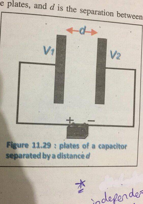

Is there a figure with the plates? We cannot answer that question without knowing the geometry the book assumes. Again, look for a better book. Electric fields are vectors!
Likes alan123hk
It's not of much help, but here it is.

Take the figure you posted. What's lacking is a clear notation. So the first thing is to draw a Cartesian coordinate system. Let's put the origin on the plate connected to the +pole and make the ##z##-direction perpendicular to this plate pointing to the other plate. Now it's clearly set up.
To calculate the field we neglect fringe effects, i.e., we consider the plates as very large compared to the distance, i.e., we look for the field not too close to the edges. Then by symmetry the potential must be a function of ##z## only: ##\phi(\vec{x})=\phi(z)##. Now within the plates you have ##\vec{\nabla} \cdot \vec{E}=-\Delta \phi=0##. This implies that ##\phi(z)=A z + B## with integration constants ##A## and ##B##. We can arbitrarily choose ##B=0## since the potential is anyway only determined up to a constant. Further you know that there's a potential difference ##\phi(0)-\phi(d)=V##, where ##d## is the distance between the plates, because ##V## is the voltage of the battery and the plus pole is at the higher voltage (more precisely at the higher electromotive force, but that's a detail only relevant if you want to analyze how a battery works electrochemically). This determines ##A##: ##\phi(0)-\phi(d)=-A d=V## So you have ##A=-V/d## and thus ##\phi(z)=-V z/d##. The electric field is ##\vec{E}=-\vec{\nabla} \phi=\vec{e}_z V/d##. So specifying clearly a coordinate system and just doing the calculations makes the determination of the correct sign very easy, and it should also be intuitively clear that the sign is correct, because the electric field points from the positively charged plate to the negatively charged plate, and that's what we indeed got from our analysis of the potential.

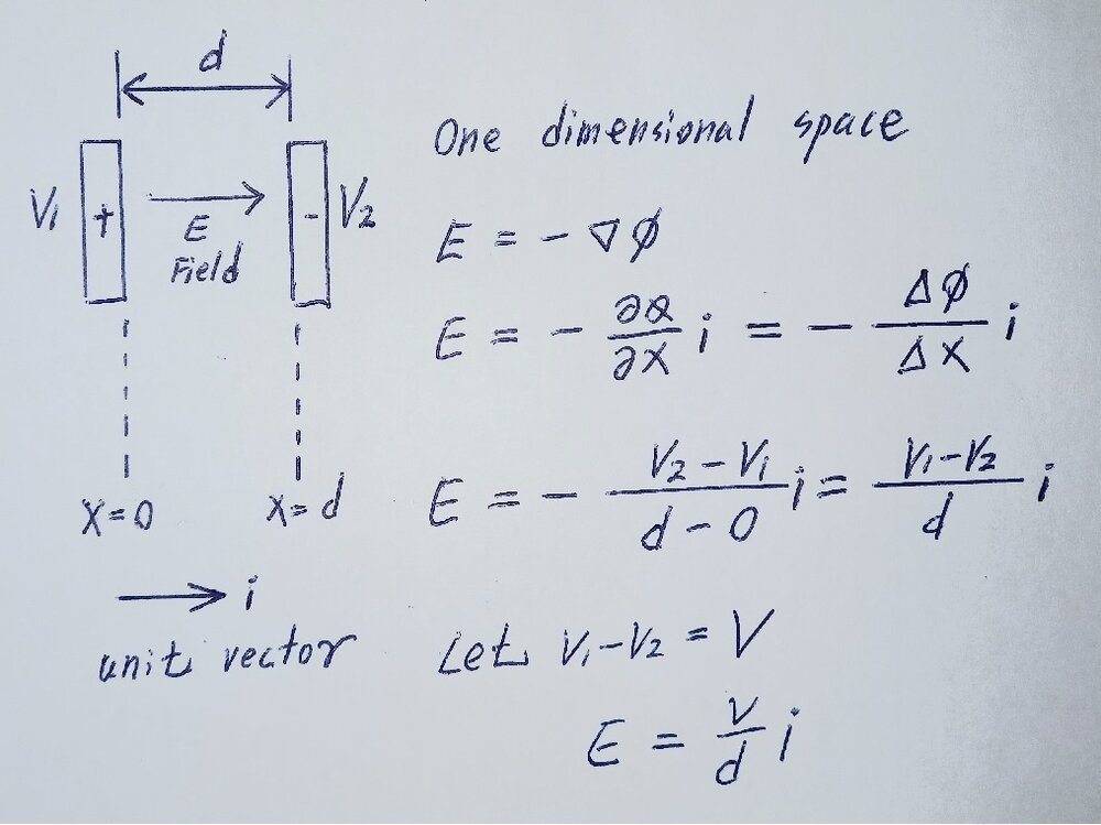

I personally use the simplest method below to understand the equation of the capacitor electric field vector.

Now here comes the tricky part. The denominator is a displacement and has magnitude and direction. The magnitude is the plate separation ##d##. Let's pick a direction from positive plate 1 to negative plate 2. Then the potential difference in the numerator is ##\Delta V=V_2-V_1## and this is a negative number because the negative plate is at a lower potential. Then ##E=-\dfrac{V_2-V_1}{d}## is a positive number which means that the E field points in the direction of the displacement that we chose. At this point we choose a symbol for the positive difference in the numerator whichever way the difference is taken, ##|V_2-V_1.## We call this positive difference "voltage" and we give it the same symbol ##V## as the potential function. It's not a very good choice but it is what it is. To avoid confusion we have to understand the context under which symbol ##V## is used because it can stand for two different things, the function ##V(r)## and the difference between two points in space at which this function is evaluated.
Your confusion stems from being unable to separate the two contexts when you see ##V## used in the same equation with different contexts. I don't blame you for this and I hope that you will get used to it after you have digested the duality of ##V##.
As I was typing this I noticed that @alan123hk posted and says essentially the same things.
Likes vanhees71 and alan123hk
  • #32
kuruman said:
As I was typing this I noticed that @alan123hk says essentially the same things and includes a diagram
Yes, we must first assume that the electric field is uniformly distributed, because we want to find the electric field in the direction pointing from V1 to V2 or x=0 to x=d, so the amount of change should be V2-V1 and d-0.

kuruman said:
The equation that you want me to consider is the source of your confusion. The definition of the electric field, as other have already said, is (in one dimension ##r##) ##E=-\dfrac{dV}{dr}## not what you have. When you say E=-V/r, you equate the ratio of small differences to the ratio of the function ##V## to independent variable ##r## and then you wonder where the difference ##\Delta V## came from. When the field is uniform as between parallel capacitor plates, the ratio is constant whichmeans that the ratio of small differences is the same as the ratio of large differences in which case you can write ##E=-\dfrac{dV}{dr}=-\dfrac{\Delta V}{\Delta r}.##
This is the bit I don't understand.
I'm beginning to understand everything. HOWEVER, I still am confused about how V turned into a difference. I'll try to keep this simple, so I understand it better. When we derived the formula, E = -V/r (ignoring whatever symbol we use, it maybe V or anything else), we said that V represented the electric potential at a point in space due to a point charge. So, in the formula, V was the electric potential, meaning the difference between the potentials of a point in the field to a point in infinity. Now how did you change the difference of potentials at infinity and at a point within an electric field, to the difference in potentials WITHIN an electric field.
I'm sorry if I seem a bit annoying, it's just that the book I'm getting my information from is a course book, which is like a 100 years old, has NO CALCULUS, no mention of any in-depth information about anything, at all. The only thing I learned was that once they finally derived E = -V/r, they mentioned V to be the electric potential at a point in space w.r.t a point at infinity. So, what I understand is that, sure, V can be a difference, but only a difference where one of the points must be at infinity. So, how come this difference now includes BOTH points to be within an electric field?
This is how I interpreted the formula. So, I guess now you can better understand where I'm messing up...?
