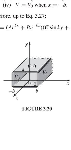

TL;DR Summary: Independence of potential( inside a rectangular pipe running along z axis)from z coordinate
Consider the following diagram
It is an infinite rectangular pipe running along z axis.I know that the potential inside the pipe is independent of z coordinate, but I cannot seem to convince myself of it.My guess is that it has to do something with uniqueness theorem.
Welcome to PF. I've moved your thread to the schoolwork forums.
What equations would apply to this problem?
Symmetry, I'd have said. Everywhere along the axis looks like everywhere else.
