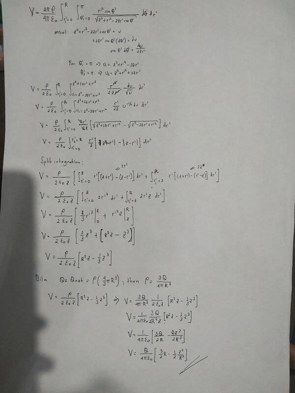

Ok, should I integrate from r' = 0 to z and from r' = z to R ?
Yeah, I can calculate the potential using Gauss Law and want to determine the same potential using another method. ..
I really appreciate if I can find the answer in this thread...

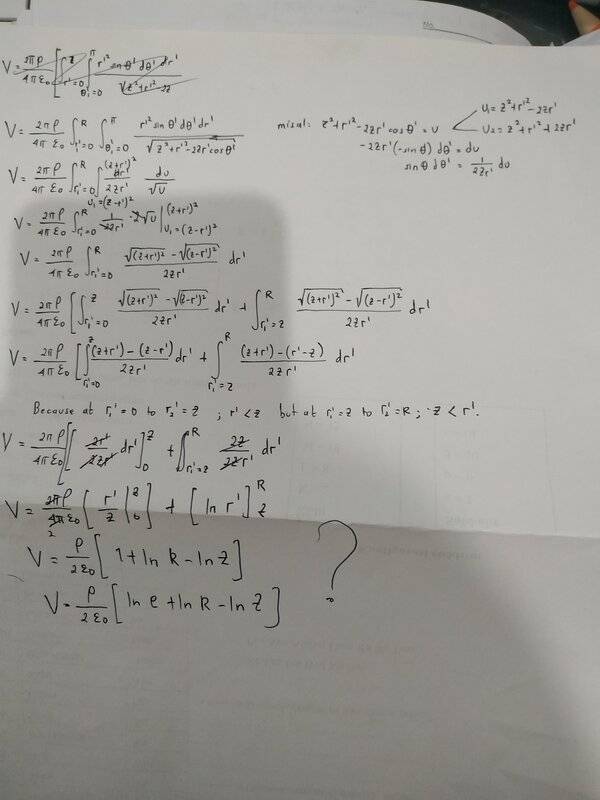

  • #36
You made an algebra mistake when you changed variables from ##\theta## to ##u##.
Likes agnimusayoti
  • #37
Shoot, I forget to bring r'^2. Thanks now I have the solution pals!
Is it a general approach to place the point of analysis in z Axis for spherical simmetry? Thanks
It looks like on the last line you may have accidentally moved the factor of ##R## in the first term out of the denominator. The way I like to write the final result is
$$V(r) = \frac{Q}{4\pi\epsilon_0 R}\left(\frac 32-\frac 12 \frac{r^2}{R^2}\right).$$ The factor out front is the potential at the surface, and it's multiplied by a unitless factor that varies from 3/2 at the origin to 1 at ##r=R##.
Is it a general approach to place the point of analysis in z Axis for spherical symmetry?
You might try set up the integral for an arbitrary point. You'll find you end up with an integral that's much more complicated to evaluate, and you'll see why choosing a point where ##\theta = 0## makes a lot of sense.
