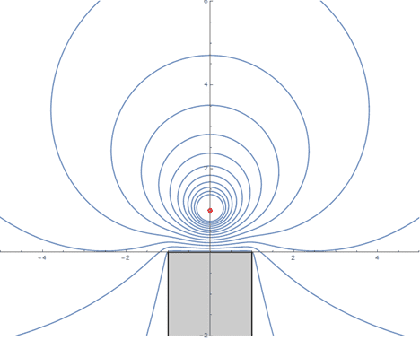

We have an infinitely long wire with charge density ##\lambda## located at ##x=0,y=h##. We also have a semi-infinite strip of a conductor ##|x|<a/2, y<0##. We need to find the potential in all space. The hint is to use conformal maps.
$$\nabla^2 = 0$$
(U=constant at the boundary of the conductor)
$$U = -\frac{\lambda}{2 \pi \epsilon_0} ln(r)$$
The general idea is to conformal map the strip to a more simple geometry where I could use the method of image charges. I've had two attempts at doing that:
In first attempt I've simply first used the map ##f(z) = z*i## to rotate the strip and then using ##g(z) = \frac{z+a/2i}{z-a/2i}(-ia/2)## (sending -ia/2 to 0, 0 to ia/2 and ia/2 to inf) effectively strecthing the strip to the first quadrant. Finally I wanted to use ##h(z) = z^2## to map the first quadrant to upper half plane. I must've visualised ##g(z)## the wrong way as this map mapped my wire ##z=ih## inside the upper half plane.(When it was originally outside the conductor)
The second attempt started in a similar way. I use ##f(z) = zi## to rotate the strip. Then I use ##g(z) = e^{\pi z/a}## to map that to ##{|z| >1 , Re(z)>0}## Using ##h(z) = z^{-2}## I map this to the unit disc and then using ##i(z) = \frac{z+i}{z-i}(-1)## I map the disc to the upper half plane again. The problem this time was the use of the exponential fuction. It made my potential peroidic(which looking at the original problem it shouldn't be), since exponential is periodic in complex.Where did my thinking go wrong in these steps? Could I avoid the use of exponential functions and still map to a simple enough geometry to solve analitically somehow?

Is there some trick in modifying the map that we're missing?

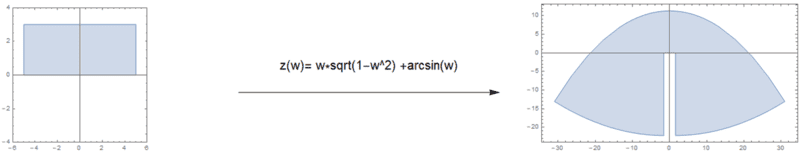

To go from concave to convex, change the "bending angles" ##\beta## and ##\gamma## from ##\pi/2## to ##3\pi/2##.

I get a mix of functions for the inverse map. Choosing -1 and 1 as the images of the two corners and taking those corners to be at 0 and i: ##z=f^{-1}(w)=K(\frac 12w\sqrt{w^2-1}-arcosh(w))##, where ##K=\frac 1{\pi-\frac i{\sqrt 2}}##.
I hope that's wrong, because it makes it hard to figure out where the point charge maps to.
You're getting similar to what I got. I chose ##K = i## and got ##z = \frac{1}{2}\left( w\sqrt{1-w^2} + \sin^{-1}w \right)##. The conducting strip then has the right orientation and position. The strip has a width ##\pi/2## which can easily be changed with an overall real scale factor.
Any point on the positive imaginary ##w## axis gets mapped to the positive imaginary ##z## axis. So, the point charge gets mapped to where we want.
Here's an example of how a rectangular patch in the upper half of the w-plane gets mapped to the z-plane.

Yes. If the point charge is at some specified height h above the strip, then it looks like you need to numerically determine the position of the charge on the imaginary w axis. The mapping function from w to z apparently has no simple inverse.

Yes, the mapping is the "wrong way" and inverting it looks impossible. But, it can still be used for finding the equipotential lines in the z-plane by mapping the equipotential lines in the w-plane to the z-plane. Here is a plot of some of the equipotential lines.

Yes, and indeed it does seem there is no closed form inverse in this strip case.
But I just went back and reread the orginal question. Either I missed it before or later forgot that this a 3D set-up. Conformal mappings are 2D. Is it valid to map the XY plane conformally but leave the Z axis unchanged? I.e., can the wire be represented by a straight wire in the image? I would think not.

By using the reflex angles as TSny suggests, the "overlap" in the mapping should only be within the conductor. This makes it ok since all those points are at the same potential, so the ambiguity creates no conflict. But I have not checked whether this is the case.
I tried to apply it to my quadrant example. This might be invalid because instead of a "triangle with a vertex at infinity" I have two vertices at infinity. The map I got is ##z^{\frac 23}##, which does indeed map the three non-conducting quadrants to a half plane.

The conducting strip and the wire are assumed to extend to infinity in the + and - Z directions. So, the potential has no Z dependence. Laplace's equation in 3D reduces to Laplace's equation in 2D.
TSny said:
The conducting strip and the wire are assumed to extend to infinity in the + and - Z directions. So, the potential has no Z dependence. Laplace's equation in 3D reduces to Laplace's equation in the 2D.
Ah, ok, more of a slab than a strip.
