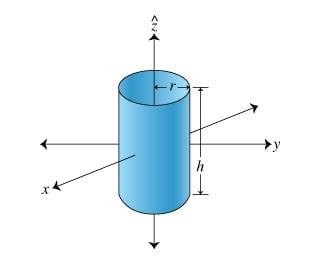

A hollow cylinder of radius r and height h has a total charge q uniformly distributed over its surface. The axis of the cylinder coincides with the z axis, and the cylinder is centered at the origin, as shown in the figure.
What is the potential V0 in the limit as h goes to zero?
Express your answer in terms of q, r, and ε0.

with h=0, the values under the root would be 1 (1+0), and the other values in the parenthesis would be zero, so we would have ln(1) which is 0, and then 0 multiplied times the rest would also be 0, but this is incorrect.
Thanks in advance for the help!

Where is Vo to be measured? On the surface I assume? And as h goes to zero, this becomes simply a circular charge distribution, doesn't it?
to perform that limit use l'hospitals rule from calculus. and like the previous states you need a reference point to calculate potential is it in the center or is it along the z axis
