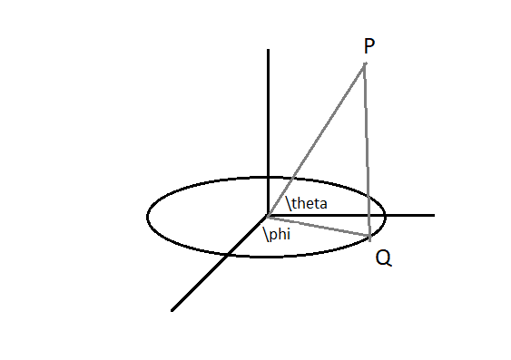

I am trying to calculate the the potential at any point P due to a charged ring with a radius = a, but my answer didn't match the one on the textbook, I tried by using
V = \int\frac{\lambda ad\phi}{|\vec{r}-\vec{r'}|}
by evaluating the integral and expanding denominator in terms of Legendre i got the following answer
V = 2\pi\lambda\sum_{n=0}^{\infty}P_{n}(cos\theta)\left(\frac{r}{a}\right)^{n}\qquad,for\;\;a>r
but the book answer was
V = 2\pi\lambda\sum_{n=0}^{\infty}\frac{(-1)^{n}(2n)!}{2^{2n}(n!)^{2}}P_{2n}(cos\theta)\left(\frac{r}{a}\right)^{2n}\qquad,for\;\;a>r
what I am doing wrong

You incorrectly assumed the angle between ##\vec r## and ##\vec r'## is ##\theta##.
Likes PhDeezNutz
Isn't it just ##\theta##!
The vectors are not necessarily at the same azimuthal angle ##\phi##.
How should I take care of this in the expansion of ##|\vec{r}-\vec{r^{'}}|^{-1}##?
Write ##\mathbf{r}## and ##\mathbf{r}’## as Cartesian vectors and evaluate ##\mathbf{r} \cdot \mathbf{r}’## that way.

If ##\mathbf{r}## is at azimuthal angle ##\phi## and ##\mathbf{r}'## is at azimuthal angle ##\phi'##, then the expansion of ##|\mathbf{r} - \mathbf{r}'|^{-1}## contains terms in ##\cos^k{(\phi - \phi')}##. This azimuthal dependence vanishes upon integrating over ##\phi'## from ##0## to ##2\pi##.

I'm not sure, whether there's a misunderstanding concerning my convention. In my notation ##\vartheta## is the polar and ##\varphi## the azimuthal angle, i.e., the relation between Cartesian and spherical coordinates of the position vector is
$$\vec{x}=\begin{pmatrix} x_1 \\ x_2 \\ x_3 \end{pmatrix} = \begin{pmatrix} r \cos \varphi \sin \vartheta \\ r \sin \varphi \sin \vartheta \\ r \cos \vartheta \end{pmatrix}, \quad r \in \mathbb{R}_{>0}, \quad \vartheta \in (0,\pi), \varphi \in [0,2 \pi).$$
The spherical coordinates are singular along the ##x_3##-axis, i.e., for ##\vartheta \in \{0,\pi \}##.
So the idea is to just use the expansion of the Green's function in terms of spherical harmonics
$$\frac{1}{4 \pi |\vec{x}-\vec{x}'|} = \sum_{\ell=0}^{\infty} \sum_{m=-\ell}^{\ell} \frac{4 \pi}{2 \ell+1} \frac{r_>^{\ell}}{r^{\ell+1}} \mathrm{Y}_{\ell m}^*(\vartheta',\varphi') \mathrm{Y}_{\ell m}(\vartheta,\varphi).$$
Then the potential is given by (for ##r<a##, i.e., ##r_{>}=a## and ##r_{<}=r##, \quad ##\vartheta'=\pi/2##)
$$\Phi(\vec{x})=4 \pi \int_0^{2 \pi} \mathrm{d} \varphi' \frac{a \lambda}{4 \pi|\vec{x}-\vec{x}'|} = 4 \pi \lambda \int_0^{2 \pi} \mathrm{d} \varphi' \sum_{\ell=0}^{\infty} \sum_{m=-\ell}^{m=\ell} \left (\frac{r}{a} \right)^{\ell} \mathrm{Y}_{\ell m}^*(\pi/2,\varphi') \mathrm{Y}(\vartheta,\varphi).$$
The integral makes all contributions with ##m \neq 0## vanish. Further
$$\text{Y}_{\ell 0}(\vartheta'=\pi/2)=\sqrt{\frac{2 \ell+1}{4 \pi}}
\mathrm{P}_{\ell}(0)=\begin{cases} \sqrt{\frac{2 \ell+1}{4 \pi}}
\frac{(-1)^{\ell/2} \ell!}{4^{\ell/2} (\ell/2)!^2} & \text{for} \quad
\ell \quad \text{even} \\ 0 & \text{for} \quad \ell \quad \text{odd}. \end{cases}$$
Plugging all this into the integral you should get the result of the textbook.
