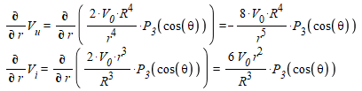

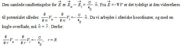

I ended doing the following. (Ignore the danish)
Here I argue that due to the boundary conditions across the surface, I get the equation at the bottom.
Using the following equations already found (##V_u## found by substituting in the term found for B, into the general solution from assignment 3.)
$$V_i = \frac{2*V_0*r^3}{R^3}*P_3(\cos(\theta))$$
$$V_u = \frac{2*V_0*R^4}{r^4}*P_3(\cos(\theta))$$
Taking the derivative of both equations:
Then setting ##r=R##, as we are on the sphere and solving for ##\epsilon_0## gives:
$$\sigma(\theta)=\frac{14*V_0*\epsilon_0}{R}*P_3(\cos(\theta))$$
Rewriting the legendre polynomial to figure out ##K## yields the following:
$$\sigma(\theta)=\frac{7*V_0*\epsilon_0}{R}*(5*\cos(\theta)^3-3*\cos(\theta)))$$
From this I conclude that ##K=\frac{7*V_0*\epsilon_0}{R}##
