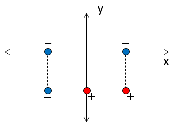

Potential of Charges on a Grid
In summary, due to symmetry, the bottom-left negative charge and the bottom-right positive charge cancel out, leaving me with a triangle around the center. I'm not entirely sure how to solve for potential at the origin specifically, but I believe that the potential energy of a system is equal to the external work needed to assemble it.
ab200
Five charges are arranged as shown below. Each charge is either +1.5 nC (red) or -1.5 nC (blue). They are spaced by 1 cm intervals (each dotted line is 1 cm long). What is the potential, in V, at the origin?
How much work do you have to do, in electron volts (eV), to move an electron from infinitely far away to the origin?
V = kq/r
U = qV
Looking at the image, I see that due to symmetry, the bottom-left negative charge and the bottom-right positive charge cancel out, leaving me with a triangle around the center. I'm not entirely sure how to solve for potential at the origin specifically, but I believe that the potential energy of a system is equal to the external work needed to assemble it.
Thus, U = k [(q1q2 / r12) + (q2q3 / r23) + (q1q3 / r13)]. But I got a very, very small number that doesn't seem right, plus U is in joules, not volts. If I divide by 1.6e-19 to convert to volts, I get an enormous number that doesn't seem right either.
What am I doing wrong in terms of problems setup?

There is a problem with your strategy. The problem is asking you to find the work that you (an external agent) have to do to bring an electron from infinity to the origin. What procedure are you going to follow to find this work? Work is denoted by ##W## but see no relevant equation that involves it. How do you propose to include that? Also, in your equation for U you have q1, q2 and q3. Which one of these is the electron charge?

You are not asked for the potential energy of the system. You are asked for the potential energy of a test charge in the field of the system. I see that same question asked twice. Once as a request for potential and once as a request for work along a trajectory.

Yes, in this case work is equal to the change in potential energy. The electron charge for part 2 of the question would be q4, with the relevant U values being U14, U24, and U34.

Yes, I figured this out. I was missing that the first part of the question actually asks for electric potential V rather than potential energy U. The equation for the electric potential of the system (multiple) of point charges is V = V1 + V2 + V3.
You’re right about the second part as well. I, not being the brightest, ended up solving for the potential energy of the system U = U14 + U24 + U34 (where q4 is the new electron charge). Given that U14 = V1 x q4, U24 = V2 x q4, etc. when I converted the final answer for U from joules in the electron volts, I ended up dividing by the value of q4 anyway.
It’s easier than that!
The total potential at the origin can be thought of as the sum of 3 contributions:
1) from the bottom left and the bottom right charges;
2) from the top left and the bottom middle charges;
3) from the top right charge.
What can you say about 1) and 2)?

I see that in 1), the two charges are symmetric about the y axis. However, in case 2) I’m a little bit confused why they cancel each other out. Yes, they are equal distances from the origin, but does that necessarily mean they cancel out? If the bottom middle and top right charges were switched, I would be totally on board, but maybe I’m still missing something.
Yes.
Don't get potentials (scalars) mixed up with electric fields (vectors).
If you were adding fields at a point, the direction (as well as the magnitude) of each individual field would be very important. You would have an exercise in vector addition.
But adding potentials at a point is much simpler – elementary addition. That's one reason why physicists often prefer to use potentials when dealing with fields - it makes the maths much simpler.
